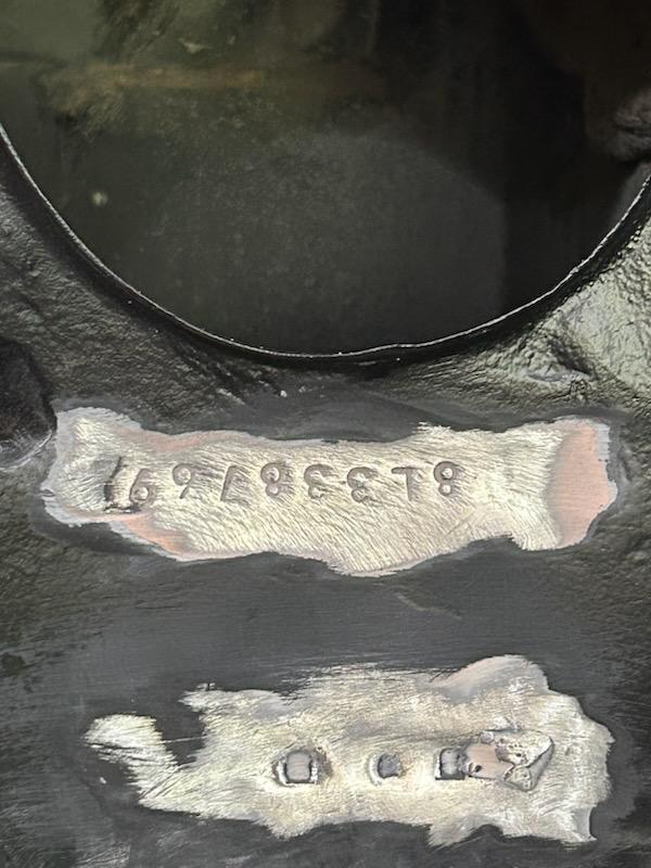

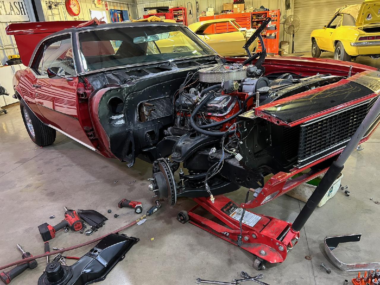

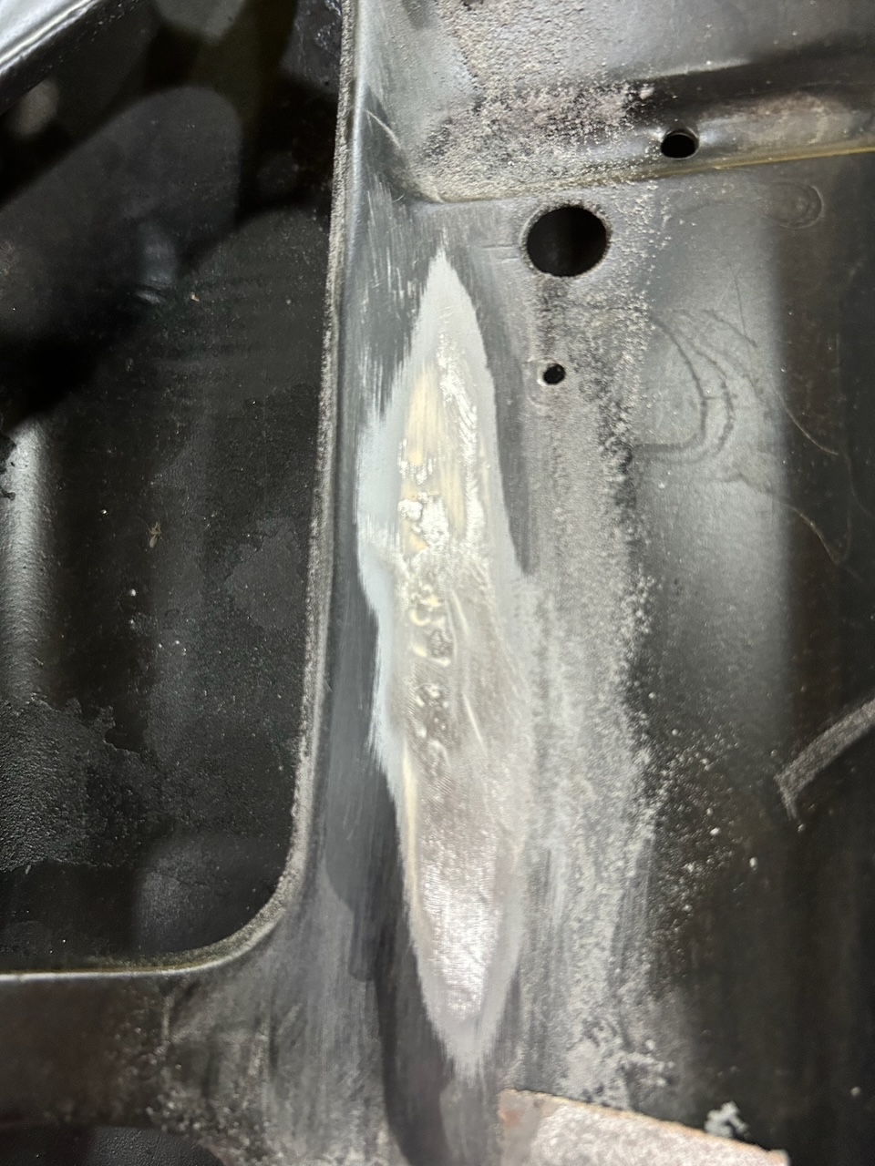

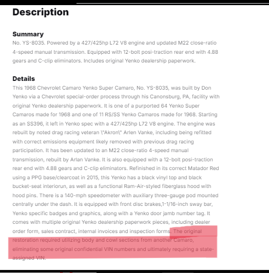

Buyer Beware. I purchased YS-8035 at Mecum Glendale 2023. I found out after the auction it was a rebody. Mecum took the car back and required the seller to repurchase. Barrett's ad states, "the original restoration required utilizing body and cowl sections from another Camaro, eliminating some original confidential VIN numbers." Needless to say, it is a little more than that. There is little out there on this car as it has purportedly been owned by the same family for 40+ years. The car has some of the best Yenko documentation I've seen, but don't be misled by the paperwork. I hate to discredit anyone's car, but a rebody is a rebody. If anyone has questions, please ask!

Scottsdale. I'm trying to post pictures now.

Just a few of the many pictures we took...

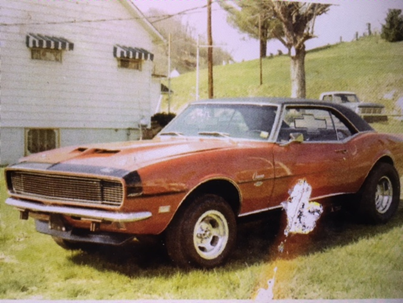

i had this in my file for YS-8035

Seems like the Barrett-Jackson description of the car is much better than Mecum's
Old 12-20-2024, 02:24 PM
Posts: 21,030
Thanked 3,771 Times in 1,509 Posts
Typical BJob.
Wait to bring the most important detail to light,
in
the
very
last
sentence.
