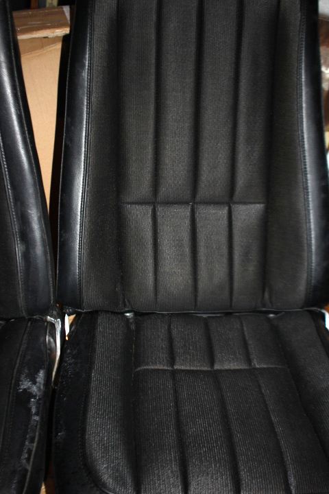

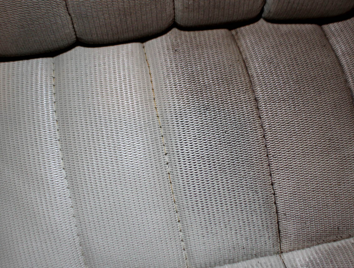

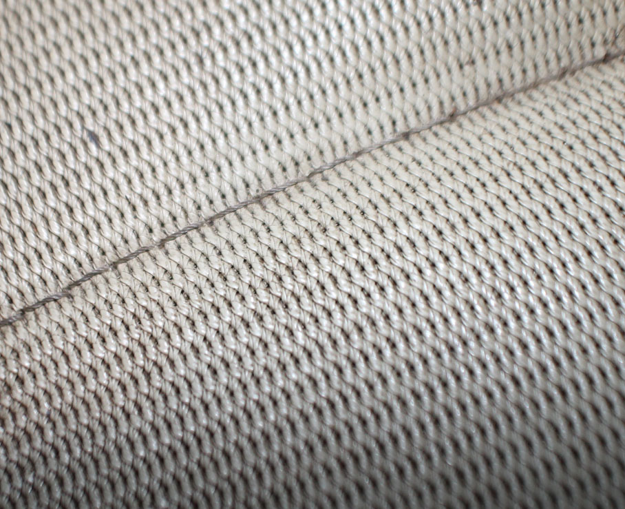

Comfort weave seats are actual individual tied little knots and thus the seats are EXTREMELY porous, they will take in everything that is spilled on them, every bit of oil grime and grease on your clothes or skin... PLUS years of Armour All and whatever else lands on them...
Because the REAL comfort weave is not manufactured any longer, the ability to refurbish original seats becomes even more important for original cars.
I had done a 69 SS Convertible with Dlx interior which came out beautifully so I knew the possibilities.
First I used a foaming bathroom cleaner(KABOOM or Scrubbing Bubbles), Spray on then using an old toothbrush lightly brush in small circles, side ways and back and forth.
Then using dilute 30 volume peroxide and a non foaming detergent pre-treat the comfort weave, NEXT extract everything with steam and commercial carpet vacuum until the extracted water runs clear... (it has an acrylic window so you can see what is being extracted.)
The first set are of my 71 corvette seats, the second are some Neutral Comfort weave for the 73 RSLTZ I am restoring.

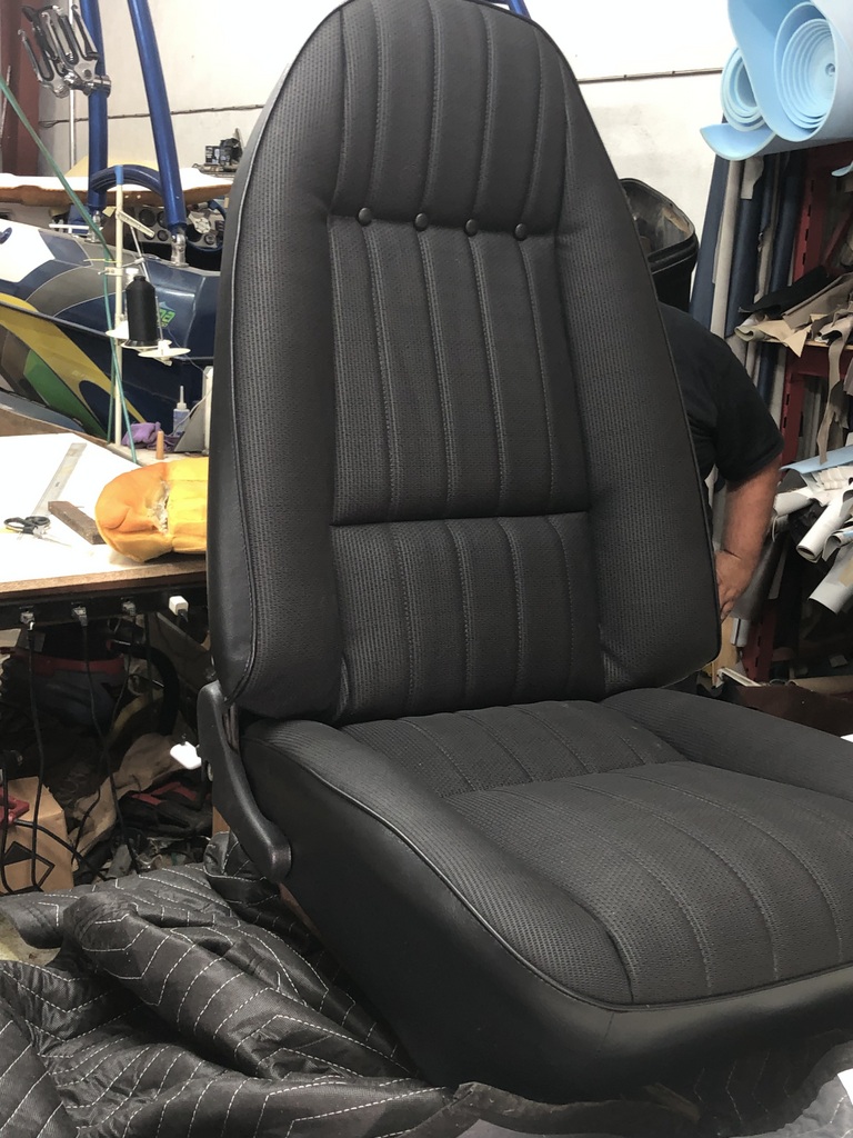

These are my 73 Camaro Z28 seats that my upholster made from NOS comfortweave. The NOS material is very coarse to the touch.

Originally Posted by McCune View Post
Great info James! I have been dreading getting anything on my seats because they look like they will hold on to everything that touches them.
Is the NOS material different than the original? I have a couple of yards coming to redo my drivers and rear seat back. The passenger seat is perfect, 0 wear or stains. Is there even a chance of a match? I don't mind a little off, just don't want it to be extreme.
Nice write-up James. All good stuff and keep it coming.

Originally Posted by BCreekDave View Post
Is the NOS material different than the original?.
It looks exactly like my my 46 year old seats, just has a very aggressive grip to it. I think a few times sitting and sliding on the seats will knock it down pretty quick.
Thanks,
Who stitched yours up?
Stitch Craft in St George Utah.
