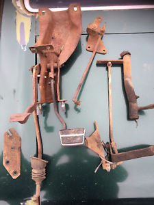

Can someone who is well versed in the complete assembly for a 1970 Camaro 4 speed set up look at the components below and tell me if they are correct for a 1970 Camaro?
Are all the brackets, linkage, Z bar, pedals etc correct?

The clutch and brake pedal pads should be the same size...
If the clutch pedal is smaller it's 1973-74 and later...
Hope this helps... Crash

Crash is correct about the bake/clutch pedal size. Hard to tell from the pic angle, but the brake pedal appears larger and the bright trim on the brake pedal pad is not correct. Also, I do not recognize the linkage linkage below the z-bar in the pic as being for 2nd Gen Camaro.
