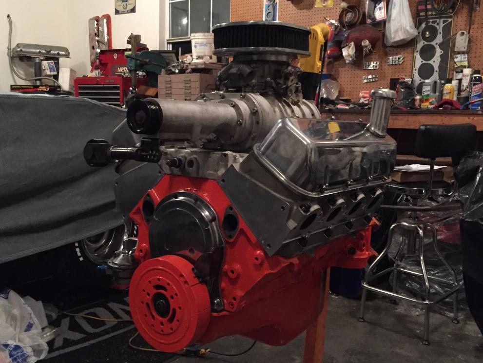

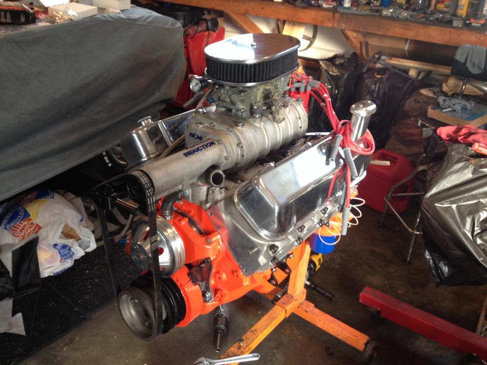

I have had a couple more engines come into the shop over the past few weeks.. Updates will be as I am done with them.. May have to change the RGR from Red Gorilla Restorations to Red Gorilla Racing.. [img]<<GRAEMLIN_URL>>/rolleyes.gif[/img] Im kidding of course since this is just a side hobby..
First is a 469ci BBC with a B&amp;M mini blower.

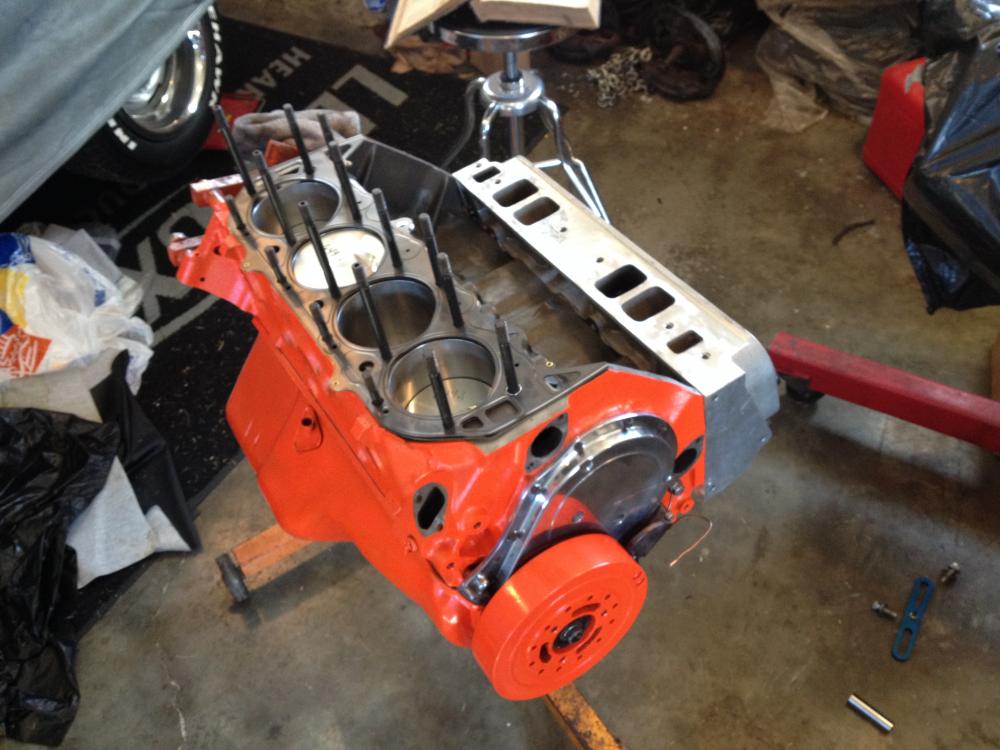

I see you Scotchbrited / wire wheeled the deck surface on the BB. I have never touched the deck surface when I rebuild my motors. Do you believe it is necessary?
Old 07-02-2015, 03:03 AM
cook_dw's Avatar
cook_dw cook_dw is offline
Join Date: Oct 2003
Posts: 4,391
Thanks: 674
Default Re: Couple new Engines in the Garage
Its out of habit. I use a scotchbrite disc on a 4&quot; angle grinder. I always do it to get a clean surface so I can lay a straight edge on the deck surface to verify its true. If its not then its added to items to be done when at the machine shop.

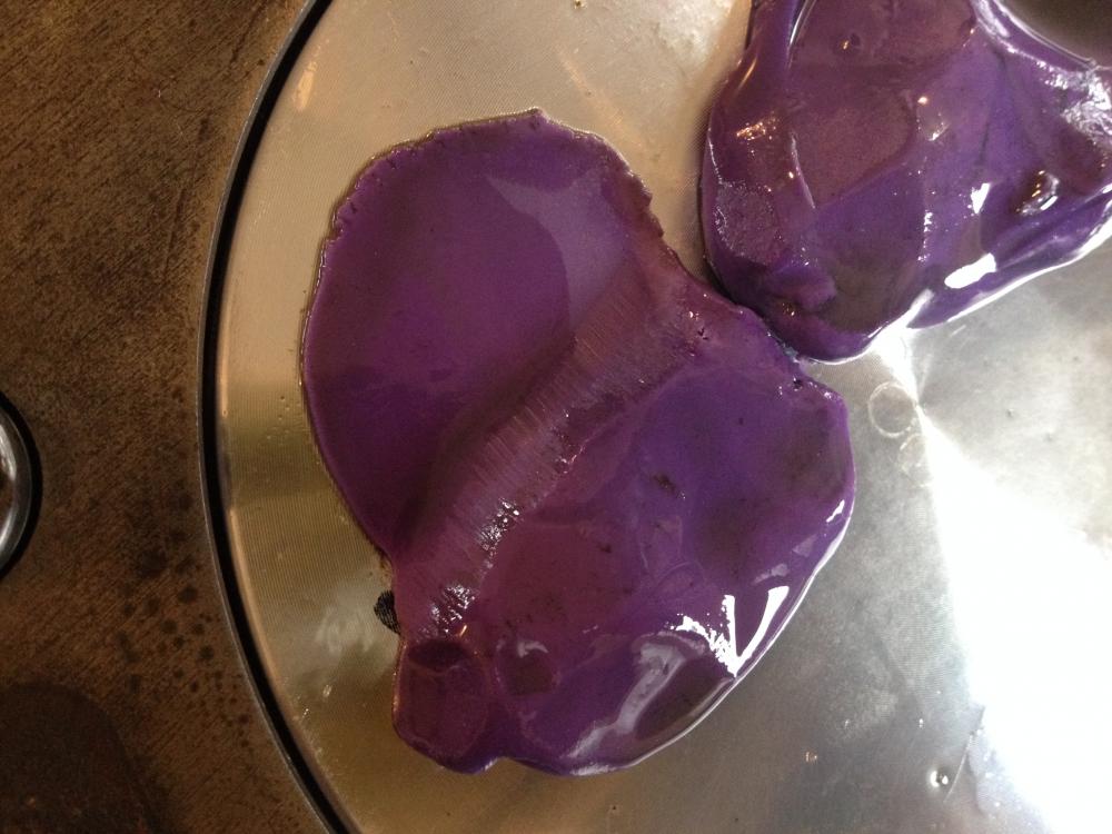

469 is out at the machine shop. Will know more about it once he makes a cleanup pass.. In the meantime, I am throwing together the LS engine. Coated the bearings and pistons today. Within the next few days Ill drop the crank in along with the pistons.
<span style="font-weight: bold">Bare block after cleaning</span>
<span style="font-weight: bold">Mains coated</span>
<span style="font-weight: bold">Rods and pistons before</span>
<span style="font-weight: bold">Rods and pistons after coatings</span>
