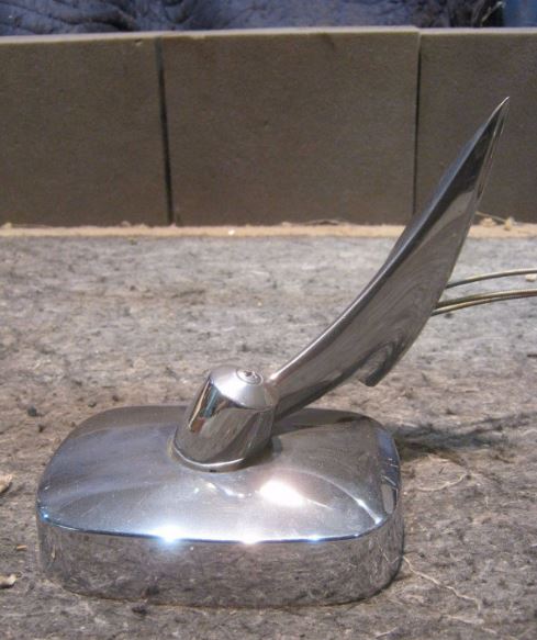

Here is what is said to be correct for 1968-1972/Chevelle. Can you guys confirm that to me?
Thanks,
Mirror #1
Old 11-21-2016, 08:07 PM

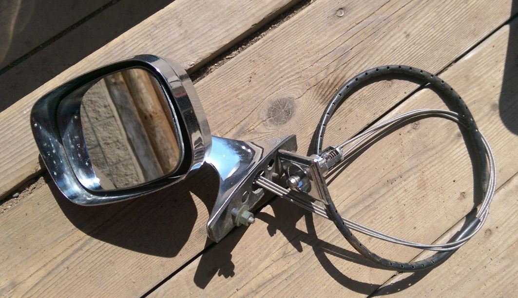

Default Re: Buick and Chevelle mirrors
Mirror #2
Should it have the drain hole on the bottom?
Thanks,

I have a NOS mirror same as your #2. Its in a GM box part number 9822423 but must be the incorrect box. That number comes up as a Bullet mirror.

Mirror #1 = 70-72 A body, #2 looks like the correct one or close (base should face fwd. and come to a point).
Steve-most probably someone put a "bullet' style on their car and put the old chrome one in the box that the bullet one came in?

Here's the one factory installed on my 69 Malibu. Same as #2 above. Which I also believe to be the same for 1968. Can't say for sure on 70 and up.
Phil

FWIW, 68 used a 3 piece mirror. There is a adjusting ring between the mirror head and the mounting arm, this allows it to pivot and fit multiple models depending on which notch is used. This is a one year only mirror.
Example. http://m.ebay.com/itm/172354321219?_...25.m3641.l6368

Phil - the pics were exactly what I needed and I was able to identify an original thanks to them.
