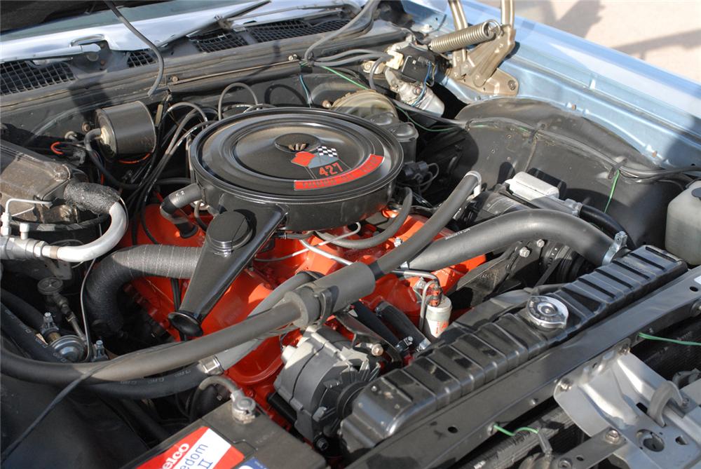

Anyone know who makes the hose and grommet fitting to connect 427 ac to vcover? shown in pic
Also is hold off valve and bracket for a factory disc brake impala exactly the same as a camaro /chevelle applications.

Looks like a '69 ....2 year only breather hose, '69-'70
The hold off valve is the same, the breather hose is not reproduced, used is best bet, same as 396, and 454 in '70 too.
any other pics?

Thanks, couldnt find that hose anywhere..Seen alot of cars use the 67 corvette flame arrestor,and then use a non correct hose to attach to it. Seems like a simple hose to reproduce
