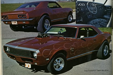

Finally put my wheels up for sale on my Camaro (16" AR TT's) and have a few guys interested so I need to pull the trigger on some new 15" Cragars so I need some help. I want to go 14x7 fronts and 15x10 rears but wasn't sure what offset will be acceptable with either 295/50/R15's or 325/50/R15's?
Would a 4.5" offset be OK? Obviously with the 15x10's I want the deep dish look but I'd rather not have the tires sticking way, way out (some is OK, but I don't want them way out there).
Anyone have any advice for me? Thanks.
