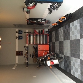

I have epoxy painted flooring in AZ and love it. It has held up well after 10 yrs. In AZ there are no worries for excess moisture in the concrete and the dry air is conducive to good epoxy adhesion. Not so much out here in OH, though. So I got to thinking about alternatives and wanted to get opinions of what has worked for you or if you have tried something similar to the Gladiator tile below what your opinion is. Price is about the same for epoxy and these tiles so that is not a factor. I will be (attempting) to place a 4 post lift in my garage so flooring able to support that is a must.

Sam I checked into those tiles for my outbuilding floor where the cars are stored and was going to install them at the end of summer. It was going to cost me just over two grand to do it so I passed for now. The company that makes the tiles I looked into is Rubber Flooring Inc. out of Chandler Az. They seem to have a nice product. My friend installed their rubber roll out mat in his garage and said it worked and is holding up fine.
Another friend of mine told me that if you want something inexpensive to put down on the concrete and will look nice is to roll out a good grade grey paint primer. He did this in his shop and it has held up very well for several years..
Other people I talk to discourage you from painting the floor due to possible adhesion issues.... [img]<<GRAEMLIN_URL>>/dunno.gif[/img]

Hey Sam...I have Race Deck flooring and a 4 post lift and there is no problem with that set-up at all. I am adding a second 4 post lift this summer.
If you are a garage journal member, call Race Deck and tell them and they wlll give you a 10% discount and free shipping [img]<<GRAEMLIN_URL>>/smile.gif[/img]
