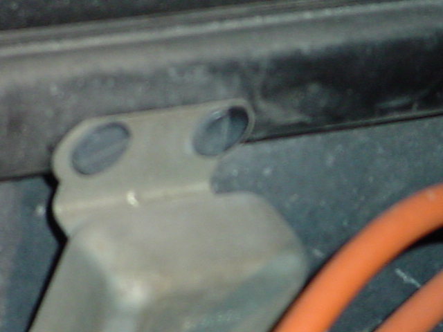

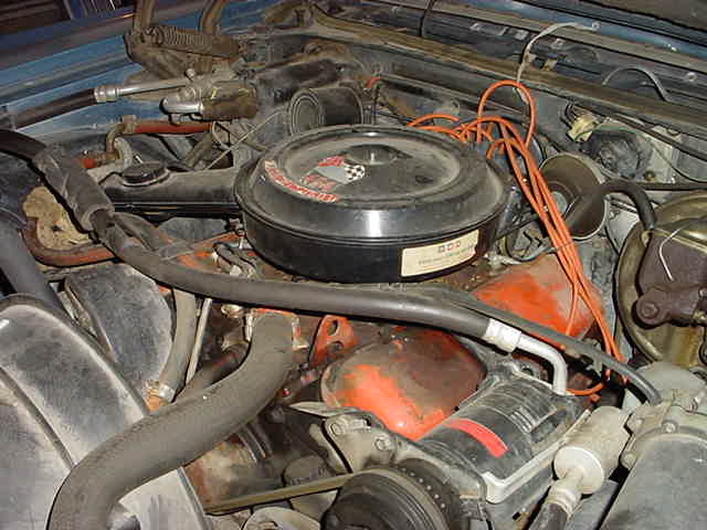

Here is a survivor 1970 SS454 Monte Carlo I looked at in New Ulm, MN manufactured on 10B/69. Notice no third hole for the ground cable and no ground cable as it was grounded at the block.

Like many items I think a lot of plants used up their inventory in many cases even though the new design was different. This Monte also had plastic rivets holding the solenoid to the wire gutter which was the first time I had seen this on a 1970 A-body.
