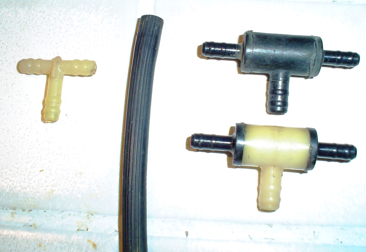

Thanks guys.. The sketch may clear things up as part of this layout was on a Fisher Body ODS and part on the AIM. I like simple easy to read drawings.
Kevin,
Can you get an image of your repop Y up so everybody has that for reference? Also If someone has an image of the correct T versus the current repop.. That may be helpful too.
Thanks. [img]<<GRAEMLIN_URL>>/beers.gif[/img]

Jim, yes I can post a pic, I have 10 left. I would like to see an original T, maybe that needs to be added to my repro list too. I just remembered! I have a bunch of RS light takeoffs in a box for decades, I will have to check them more closely!

I can snap a pic of a T later tonight.

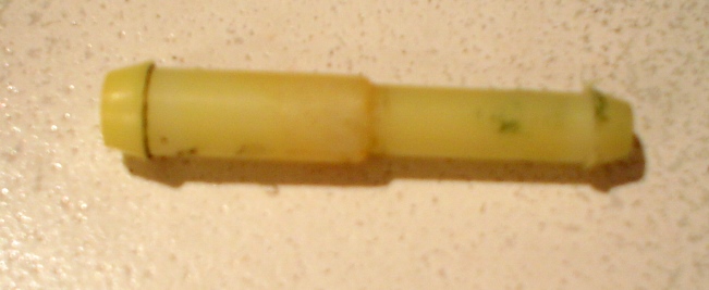

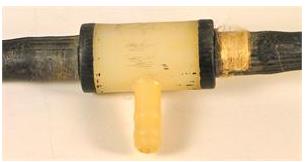

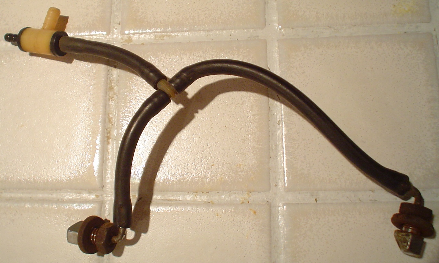

Here is Sam's pictures...
