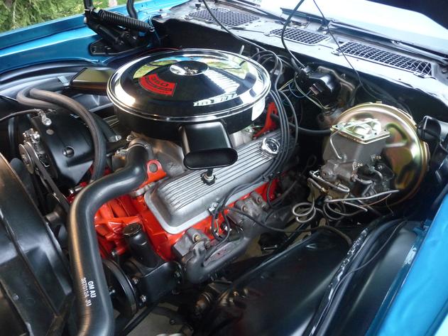

I sand blasted mine first then sprayed &quot;VHT&quot; High temperature paint with one coating and baked them in my BBQ to 450 degrees. Did a second coat and put them in the BBQ a second time and 2 years later they look better than any of my friends job they did with much more expensive alternatives. Note &gt;&gt;&gt; put a sheet of foil paper on the BBQ before placing the manifolds in there. First photo is 2 years ago and second photo is a current photo after 1800 miles. So far no surface rust or burn off.

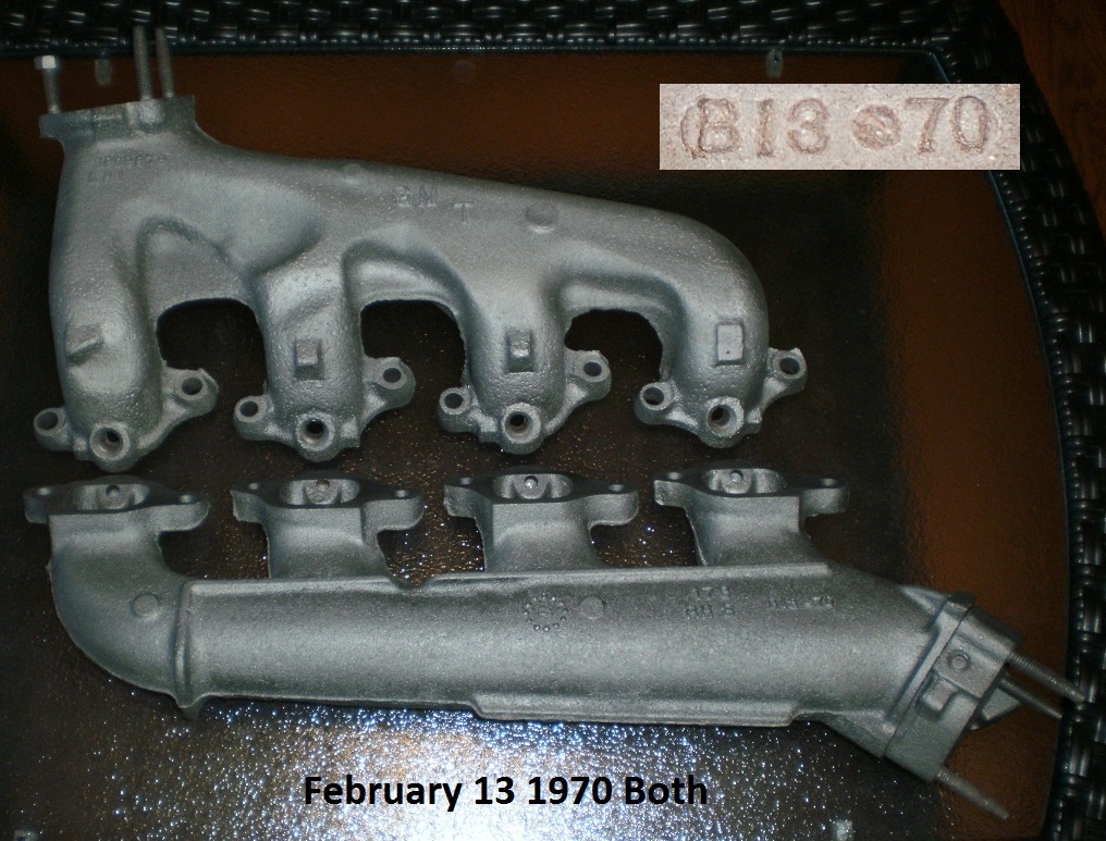

Found a photo of my manifolds right after I was finished
