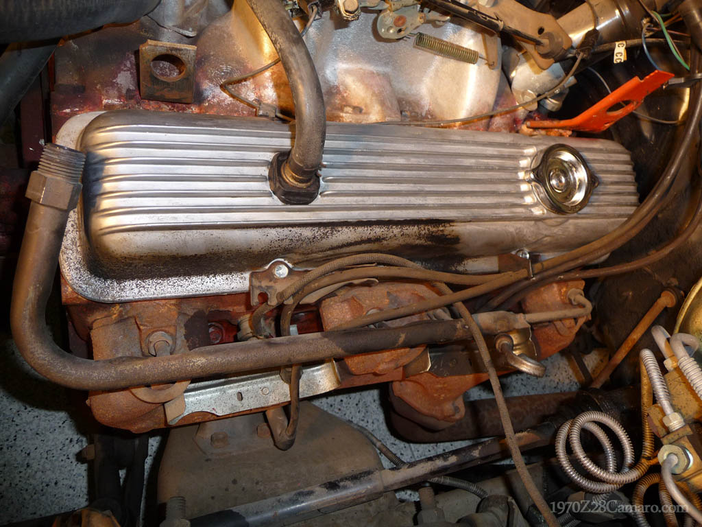

Hi guys, I have a question about a tab on a 70 Z28 carb throttle
arm. In the picture (C. Lillard's) of Charley's 1100 mile Camaro
there is a tab attached to the bell-crank that the throttle return spring
attaches to. NOT the fixed end at the rear bracket.
My engine is missing that piece. I do not know if it is a LA built only deal
since mine is a NOR car.
How is it attached and where can I get one??????
I've looked thru Holley's info, talked with Eric @ Vintage Muscle Car Parts,
and looked at a variety of online aftermarket warehouses, and dozens of pictures
of Holley carbs online.
Since Charley does not have the car anymore I'm wondering if anyone else has anything
similar or can help in discovery?
Thanks Dicky [img]<<GRAEMLIN_URL>>/flag.gif[/img]
Dicky

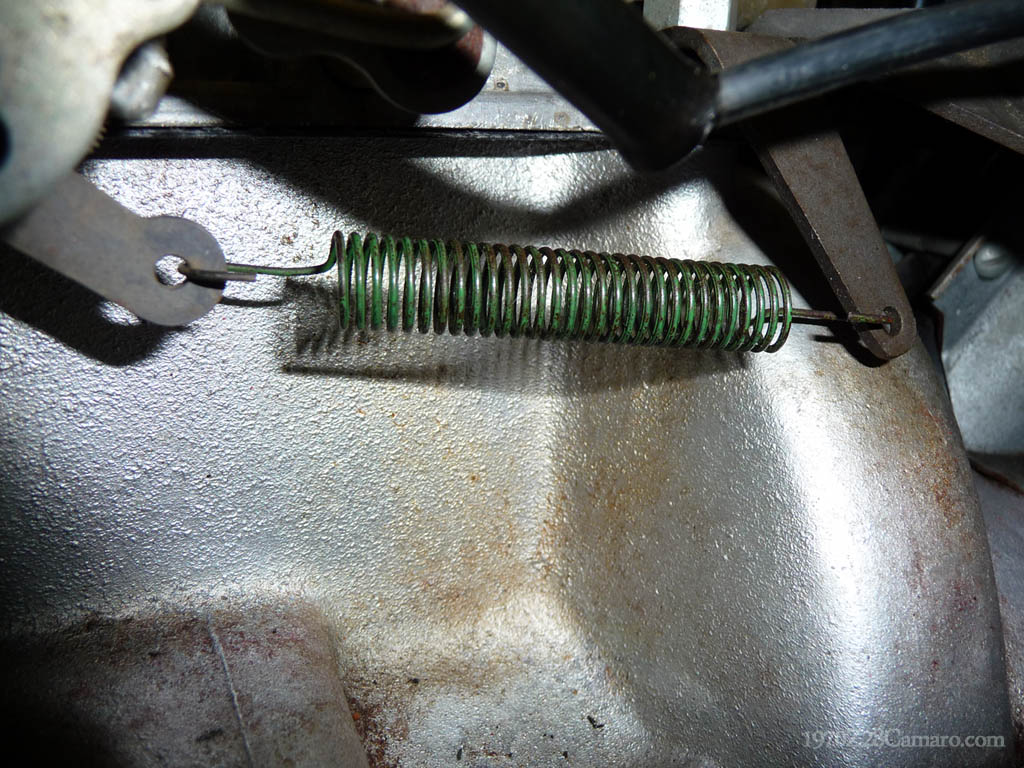

If you're talking about the front hook up for the return spring, my 4490 (70 Z28 automatic) carb has the same set up. That throttle shaft goes through that arm which is also attached to the throttle linkage and is at the lower end, the upper end has a arm that rests on an idle solenoid. What is the list number of the carb you are working with?
John Brown
Old 05-08-2014, 07:32 PM
John Brown's Avatar
Location: South Bend, Indiana
Posts: 2,820
Thanks: 455
Thanked 510 Times in 243 Posts
Default Re: 70 LT-1 carb set up
Luckily my carb was in the basement in the midst of a rebuild so it was easy to get pictures.
