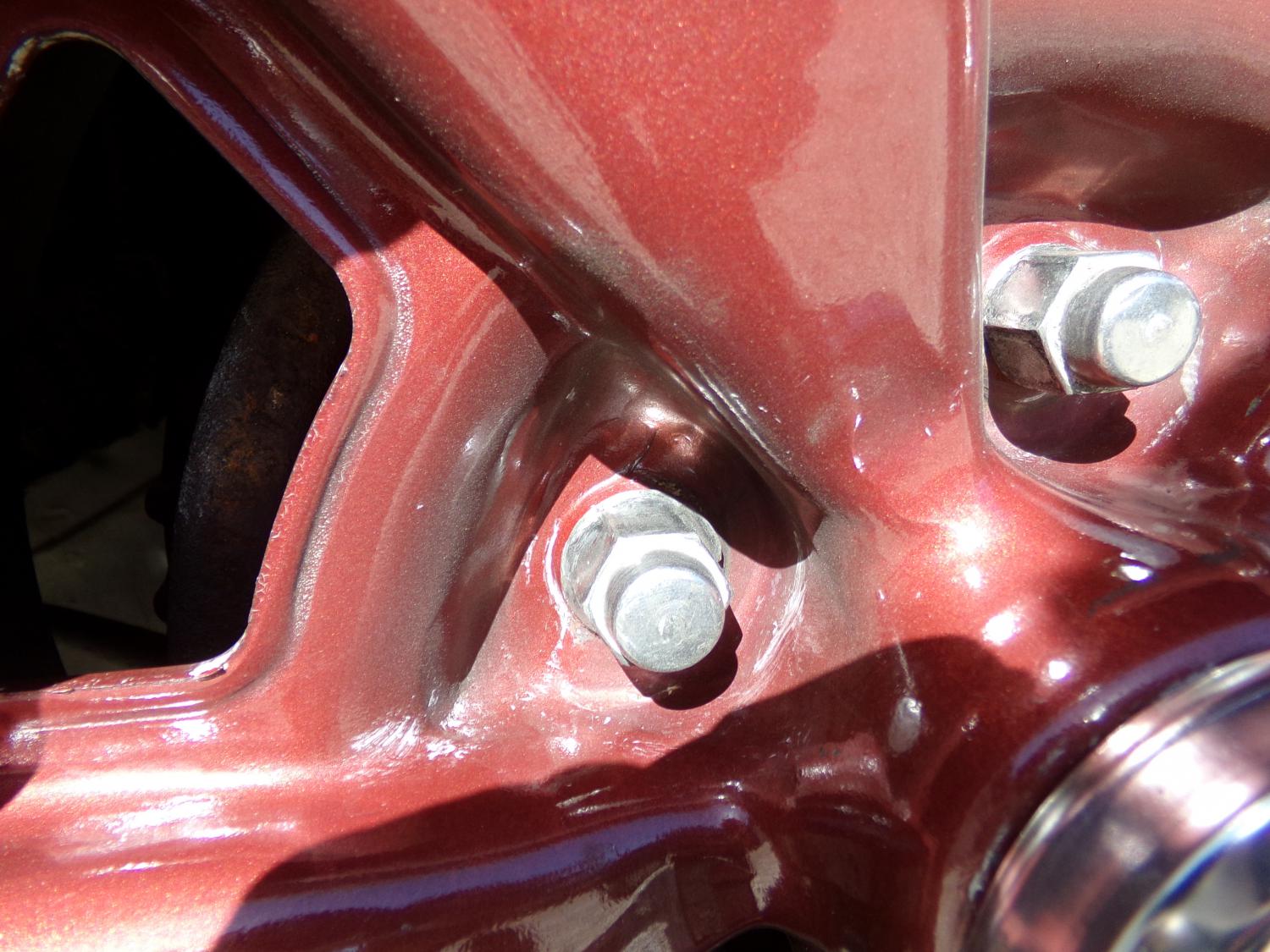

I wanted to post this here so I could get feedback from you guys. When I last had my 1978 Camaro Z28, that I bought new, serviced they marked on the Courtesy Visual Inspection form that the lug nuts (original) were going on too far, going past where they're supposed to stop and would require attention soon. Is this most likely that they are just too old and should be replaced or is this more a wheel problem where the original 5 spoke steel wheels have the wheel stud holes enlarged now where the lug nuts instead of holding the wheel tight are actually being forced into the wheel stud holes too far? I know a buddy with a 1967 Nova SS had to replace his original steel wheels because the wheel stud holes were too large and he was told it was actually a safety factor.

I don't think it is a major problem currently as by what I've been able to see just a few, not all, of the lug nuts have a splayed look to the chrome part of them against the wheel. I'll have to look further into it and will try to get some pics posted.

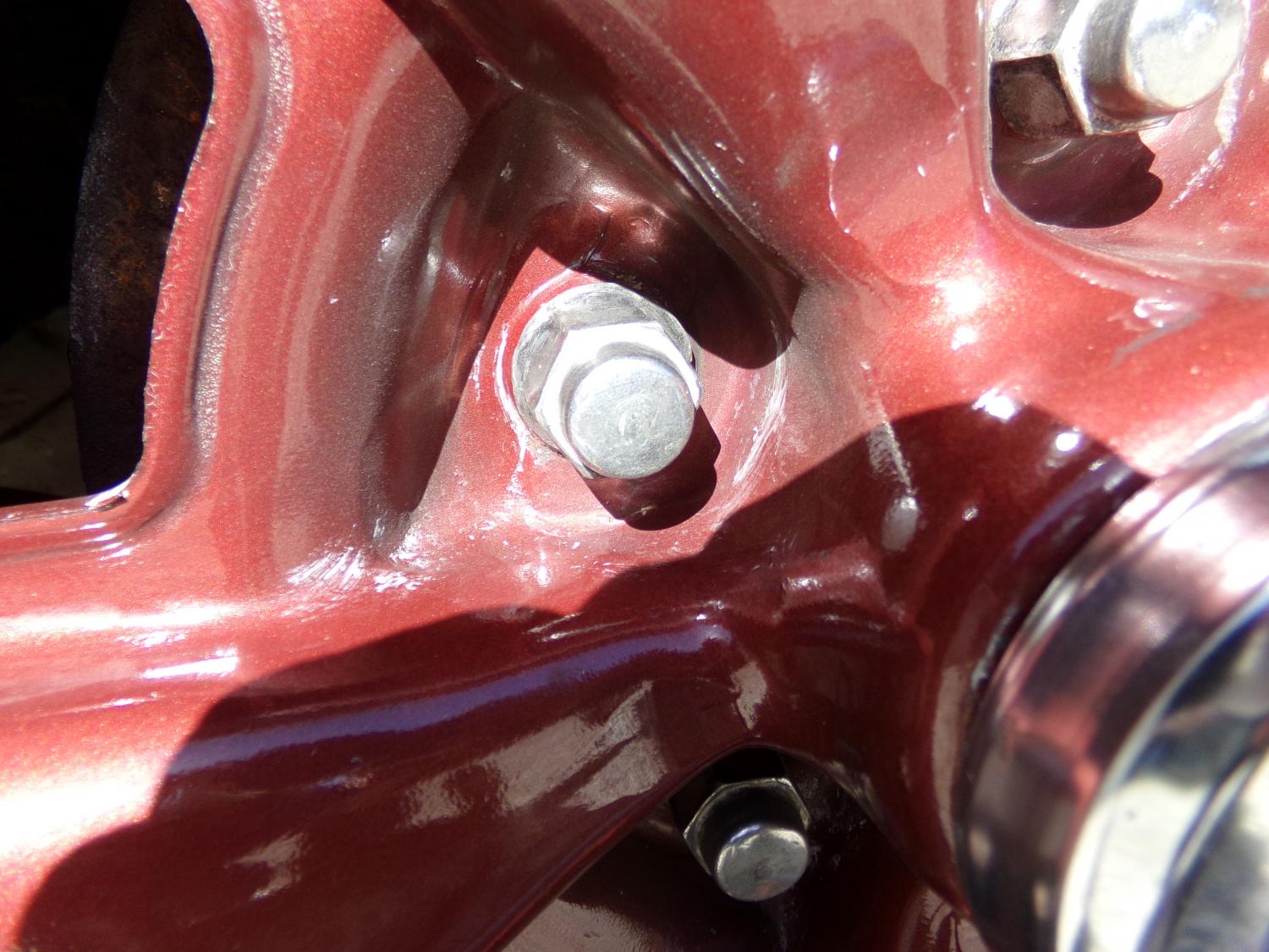

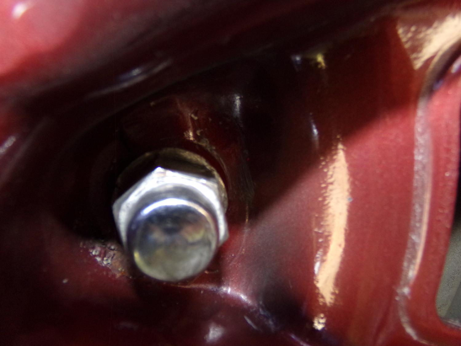

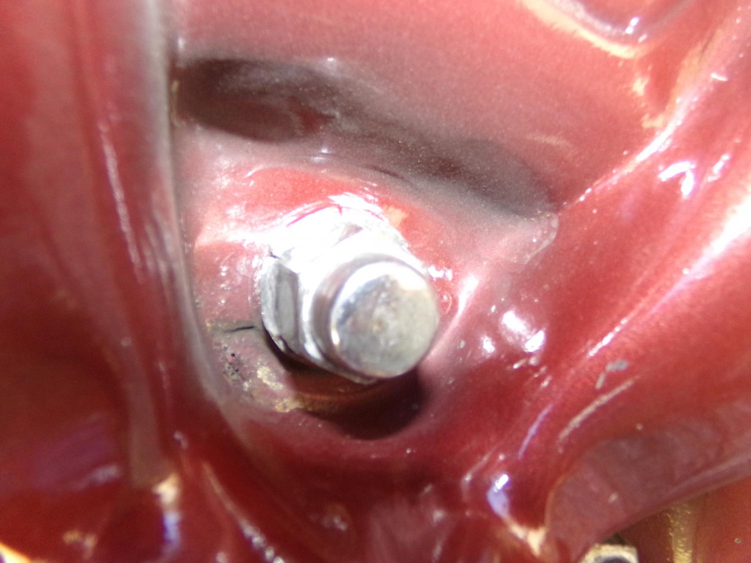

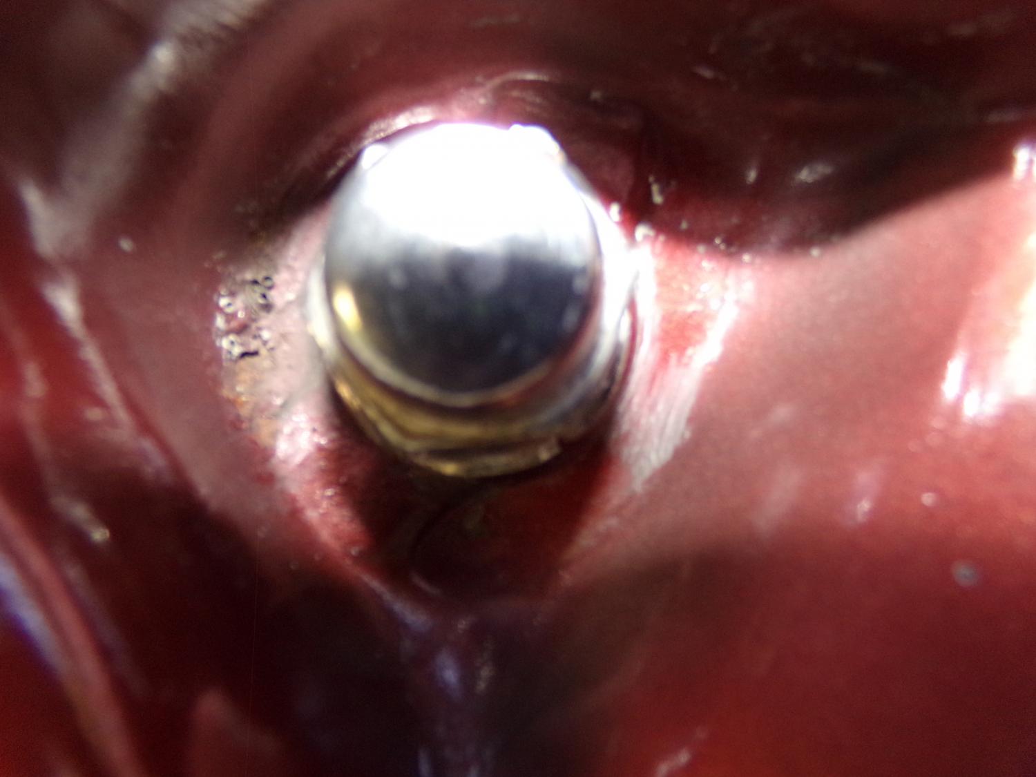

Here are some pics I took showing some of the lug nuts that have that splayed look to them.
