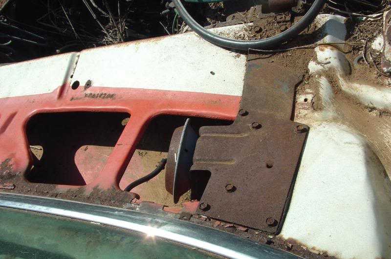

This is unrestored for sure.... Obvious Z-11 but same stripes as the Z/28.

Z11s used a template while the Z28s did not.

Template?
