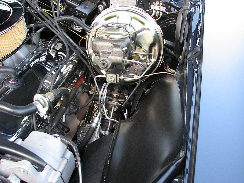

I want to replace the booster and master cylinder on my '70 SS Chevelle. Originally it looked like the only master cylinder was incorrect but on closer inspection I don't believe the booster is correct either. I would like either a restored original or a nice repro set up- should there be such a thing? What is everyone using out there?
Thanks.
Here is what is currently fitted to my car.

That master cylinder is definitely incorrect as you need a 5470409 'BB' cylinder. The booster should be a 9391. They can be found but are NOT cheap especially if restored. The Delco Moraine stamp should be on the lower left corner of the face of the booster and upside down. Repos are close but not exact and the stamping of the face has a more crisp appearance on all the stamped edges.
