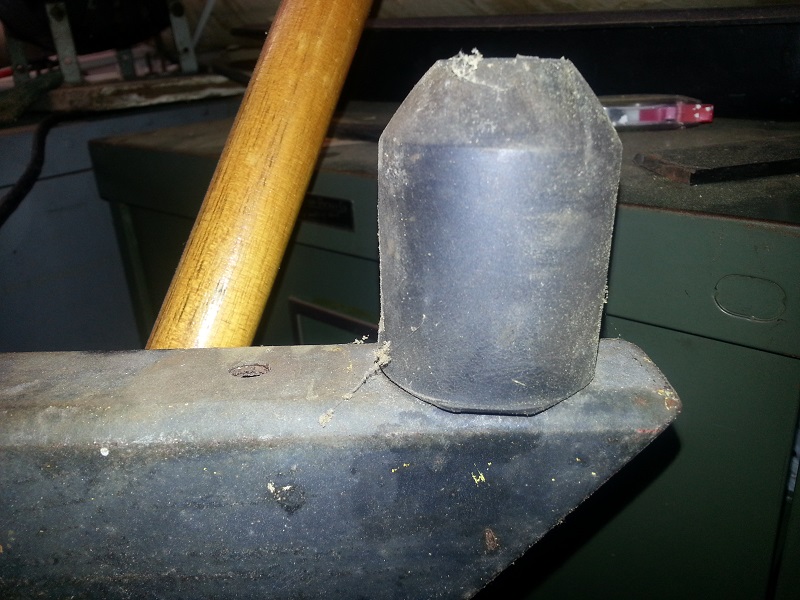

Old 12-31-2013, 11:32 PM
67rs/ss 67rs/ss is offline
Join Date: Aug 2005
Location: joco nc
Posts: 212
Thanks: 12
Thanked 52 Times in 17 Posts
Default Re: ? on 1967 Camaro old drag car.
Here's a pic of the motor stand.
