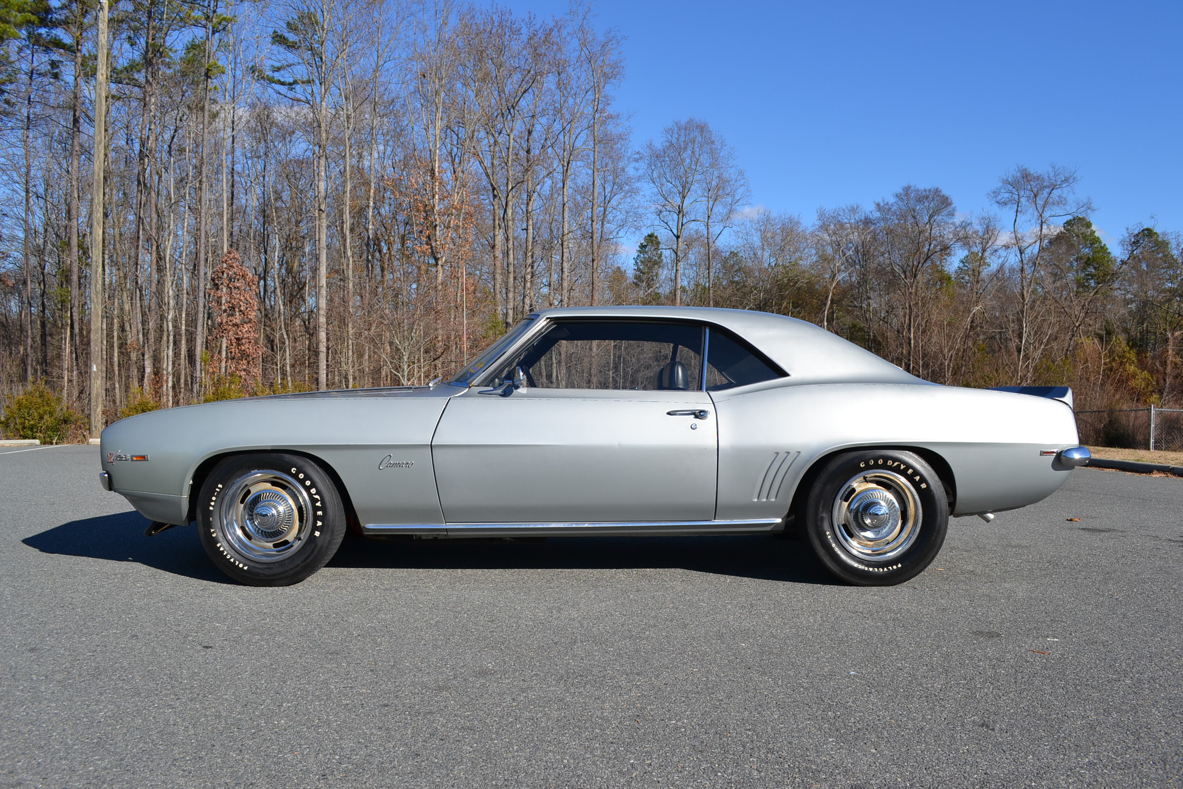

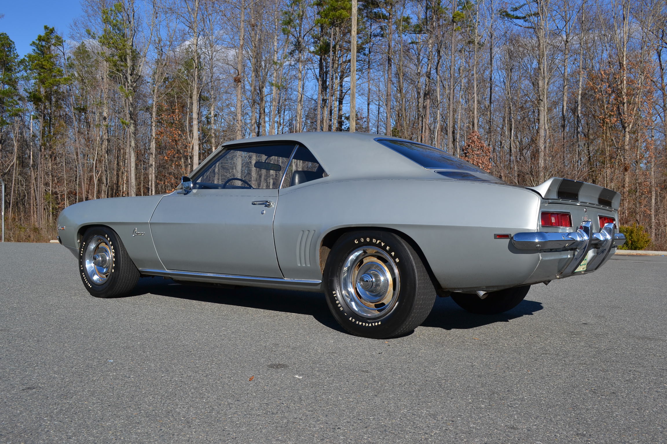

After a lot of elbow grease the ole girl is starting to look better. Still a lot of work to do yet. Pictures are very forgiving for sure. I would post several more pictures but need to learn how to resize images.

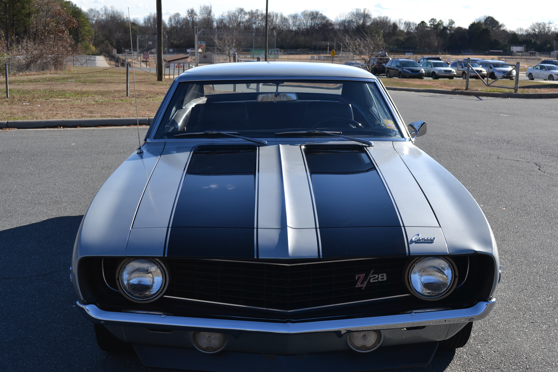

One more picture

I know the grill is wrong. I have the original but it is damaged.
