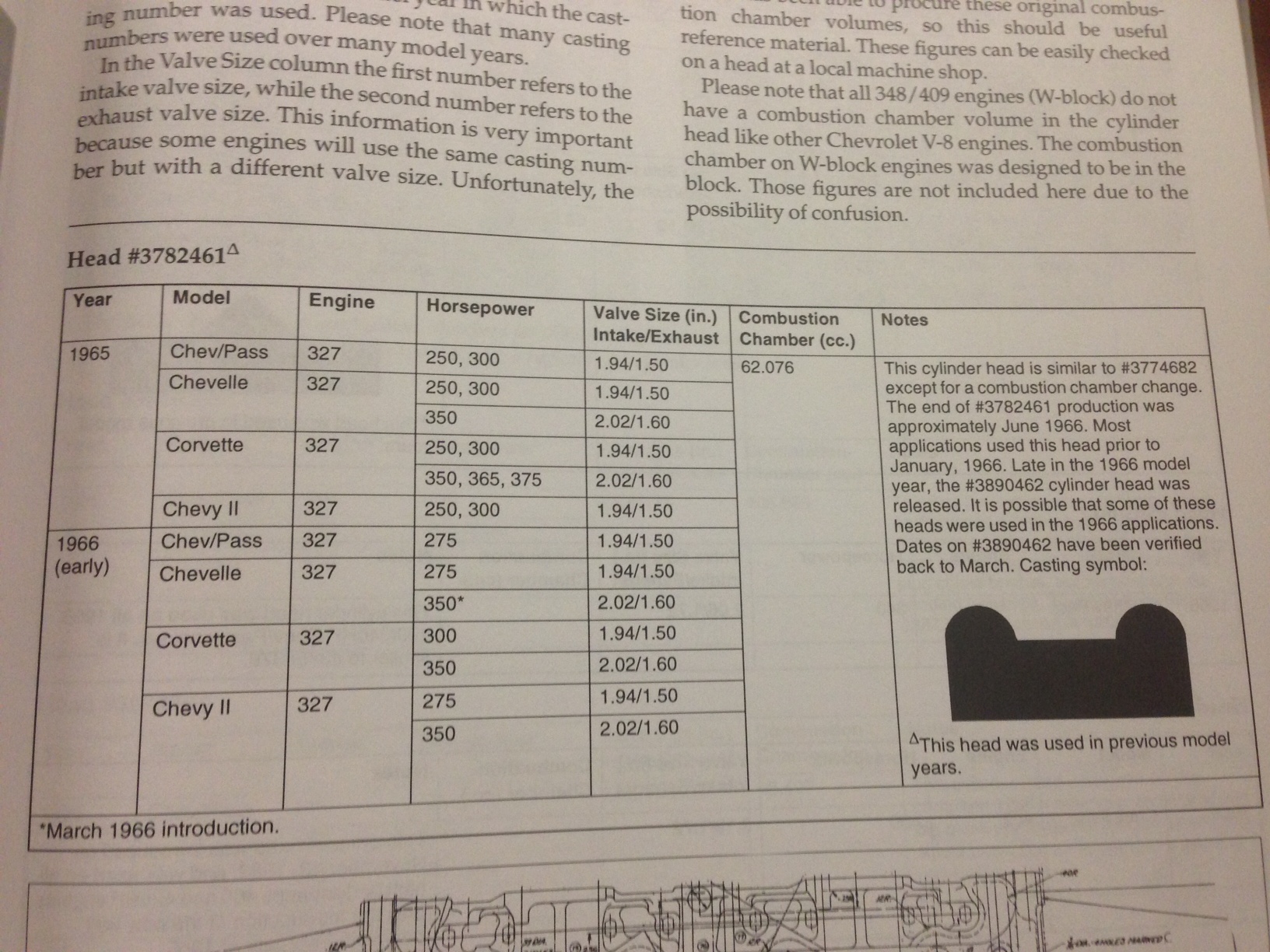

So what would be a good site that shows all the heads available in the 1960s?
I've seen a few and it's a mess.
This is more about trivia as someone on another board is claiming the 327 installed in the Opel Diplomat (327/300) had Fuelie heads. Specifically, "double-hump."
I'm guessing there's a cliche going on, but can't find the evidence to my satisfaction.
It also makes me curious if the 327/300 is the same one as the American cars or it's just rated the same but with different parts. I've emailed a German friend to see if he can help.
I guess some here may be surprised there was an Opel with a SBC!

Some guy had this book, which confirmed my suspicions.
Thanks for that chart too - pretty interesting!
