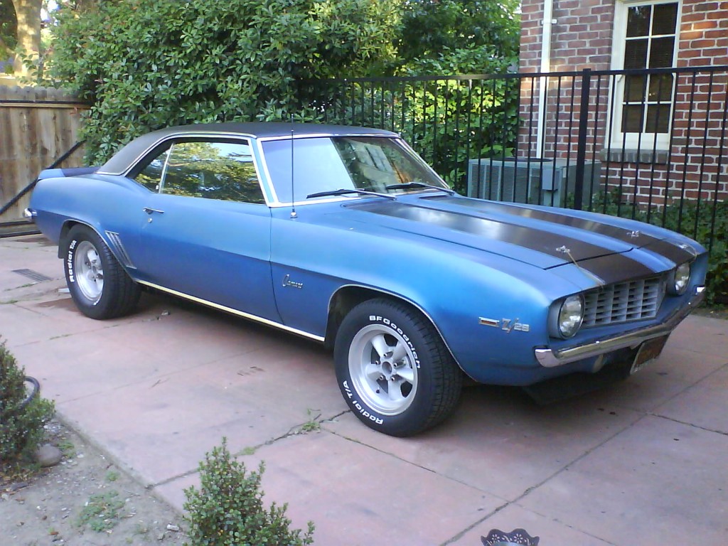

Default Re: 1969 Camaro tire size
Here my COPO with 15x4 on the front look at the deep offset of the rim it looks like a 15x6 .I have a set of thoase front rims dated 69 and rears are 15x6 thats was the old owner told me .I think the rear tire was 10"wide but i dont know about the height .I was told this was a comon thing to do little rim on a wide tire for the sick cars for traction
