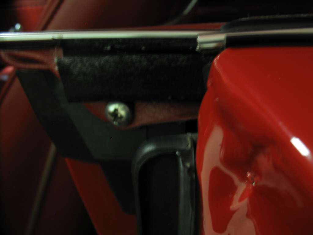

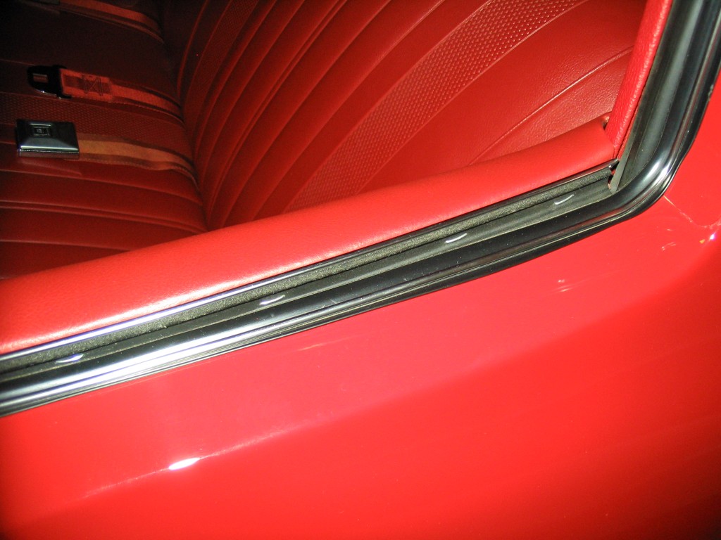

How were the window felts attached to the inside door panel and rear quarter panel trim? Any pictures plus a picture of an original quarter panel interior trim would be appreciated. Thanks in advance.

They were held on with 1/2" staples originally.
On the rears,a phillips head screw is used to fasten the beginning down also,near the windlace.
I can't share a photo of the front door panel felts,as they drop down a good 1/2" or so and are difficult to see once on the car,but they are similar to the rear.

----If you are using the original panels and only replacing the windlace you can carefully drill holes in the same place as the panels and make your own staples with wire. Works good!.....Bill S
