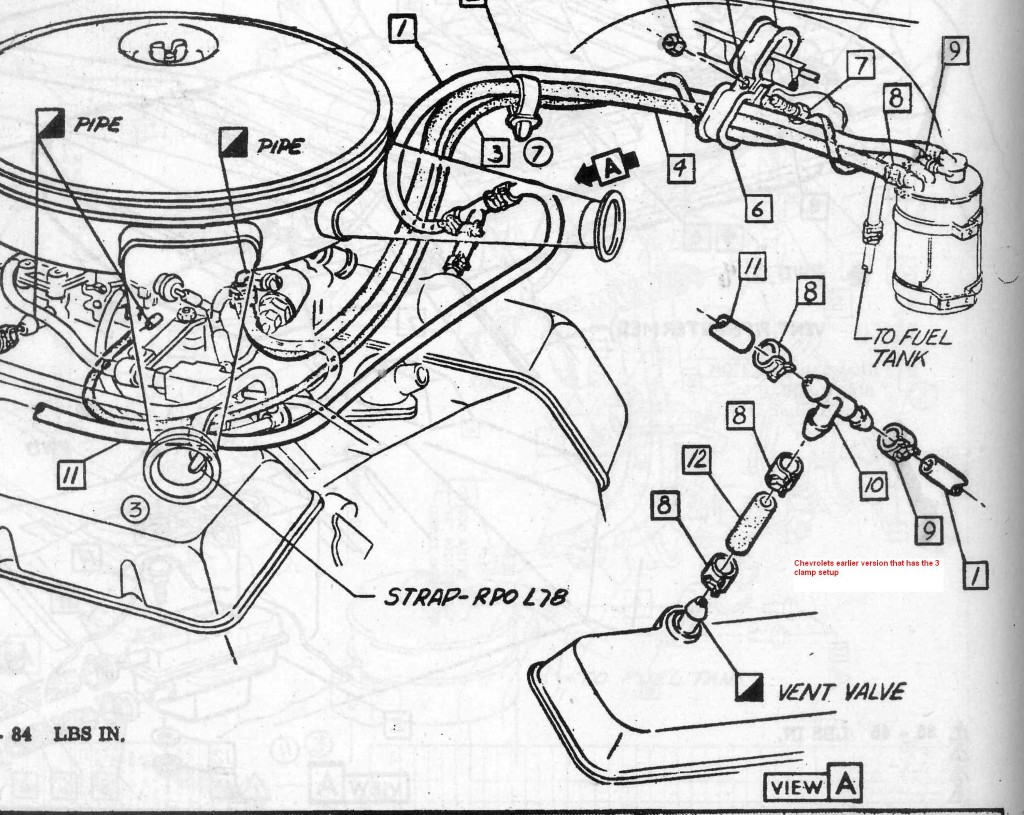

I've seen a few cars at local shows that have the carburetor head shield with the engine firing order stamped into them. Are they factory pieces and what and when is there application?

Yes they are and part of the RPO NA-9 package.
Also known as EEC for Evaporative Emission Control or Charcoal Cannister system ,or California Emissions.All the same animal.
It originally was mandatory on vehicles sold brand new in the state of California & certain parts of Nevada & Montana.
It soon became standard equipment in all states,on most vehicles as the years moved on.

Was the heat sheild and the charcoal canister system the only components of the NA9 RPO code or was there other components added.
Old 08-17-2006, 08:28 AM
Posts: 21,034
Thanked 3,774 Times in 1,511 Posts
Default Re: Carburetor Heat Shield
In addition to those two items,there was a seperator box mounted over the rear axle,special vented gas tank and gas cap,and a Special Carb with a fuel bowl vent pipe.
