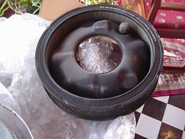

Does anybody know what this open element air cleaner base is originally for?
Rick

L88?.

By the shape of that vent elbow at 90 degrees, I'd think it fit something with a flat intake manifold like used on 70 and later engines. I have also noticed the 90 degree elbows on 69 SS350 cowl induction cars whereas the 396 and 427 performance engines had an elbow that pointed more down.

The ID cutout looks like it's for a Quadrajet.

<div class="ubbcode-block"><div class="ubbcode-header">Originally Posted By: Verne_Frantz</div><div class="ubbcode-body">The ID cutout looks like it's for a Quadrajet.
Verne [img]<<GRAEMLIN_URL>>/smile.gif[/img] </div></div>
I fit it onto a Holley and the locater fits on it too.

Rick, here are some pictures of a 69 BBC air cleaner base I had.

Aren't those the over the counter AC Delco ones from back in the day?

I guess that rules out mine from being a `69 after seeing yours pictured.

1968 327 325 base chevelle nova .

<div class="ubbcode-block"><div class="ubbcode-header">Originally Posted By: Kim_Howie</div><div class="ubbcode-body">1968 327 325 base chevelle nova . </div></div>
Your picture looks pretty much the same from the top. Do you have a pic of the tube on the bottom?
