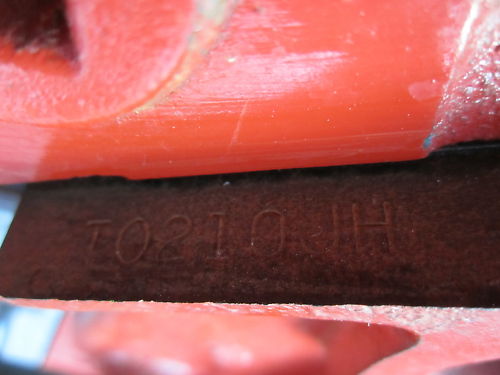

I located and purchased a 1969 Camaro 396/375hp car that is supposed to have the original born with engine and trans.
The trim tag shows the car as a 02D - 4th week of February car. The engine is stamped T0210JH - Feb 10th 396/375hp Manual Special High Performance and the vin is stamped by the oil filter. I have not gotten a chance to get the trans or rear stampings yet but will have them in a few days.
What are your opinions on the pad and vin stampings? I am attaching the trim tag as well showing it as a X22 garnet red w. 711 base interior. The tag appears to have good rivets and does not appear to have been removed.

I´m sure the experts here will chime in, but I would get ahold of Kurt S from CRG...or maybe he will chime in here...
I will say that the pad stamp sure looks well aged...and also that is the clearest vin stamp I have seen...most that I have seen are barely legible...
but I am no expert on these stampings...
sounds like a cool car if it turns out to be real!! good luck !!

I have a picture of an original L78 motor stamped seven days past this one. A Norwood car as well. On the one I have, the head must have been in place for them to stamp as you can see the angle it was stamped at.
Dave C.

-----A picture of the pad with just a bit of cleaning so as to try to judge the broach marks would help. Nothing too abrasive. Id have to say that things look OK so far, though......Bill S

I will see if I can clean up the pad or even get the head off and take a few more pics. The pad I feel pretty confident about - the vin stamping does look rather deep to me. I does show the typical varying depth where the lower portion the stamping is not as deep as the top but I am still suspect that it appears too deep.

----The depth isnt an issue with me, but I guess someone else may disagree.....Bill S

On the VIN stampings by the filter - is it common for them to be so straight - meaning that all the charactors line up so well? Also, was it ever seen where they would use an &quot;I&quot; instead of the &quot;1&quot; like they would do with other stampings? I have reviewed a few other vin stampings and the one thing that I see that is consistant is that the are all inconsistant [img]<<GRAEMLIN_URL>>/smile.gif[/img]

I agree...you should try to compare to other blocks within the same time frame..there seems to be &quot;somewhat&quot; more consistency with motors stamped within a few days.
also the trans VIN stamp should have been stamped with the same fonts/characters...(I am not sure if that is so on 100% of the cars)...if they are different, I would be suspicious...
