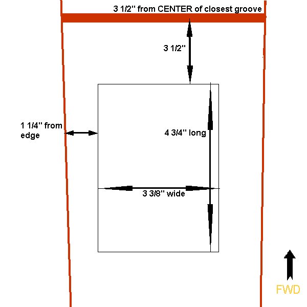

Hi,
Can anyone out there tell me the location of the 4-speed shifter hole in a new "patch" tunnel piece? No one makes a templet. My car (68 camaro) is originally 4-speed but the hole has been cut out more & more. Now I have a turbo 400 but, I'm putting the 4-speed back in & I don't know where to put the hole for the shifter! Thanks! Justin.

These are for a 69, but I believe location is the same. The 69 was cut out with a torch, but I believe the 68 is clean cut. Someone in the know correct me please, if I am wrong.

I have a 68 Camaro 4-speed with an unmolested shifter hole. It's clean cut with a ring welded on the underneath side. I'll see if I can move the console and look at the shifter hole.

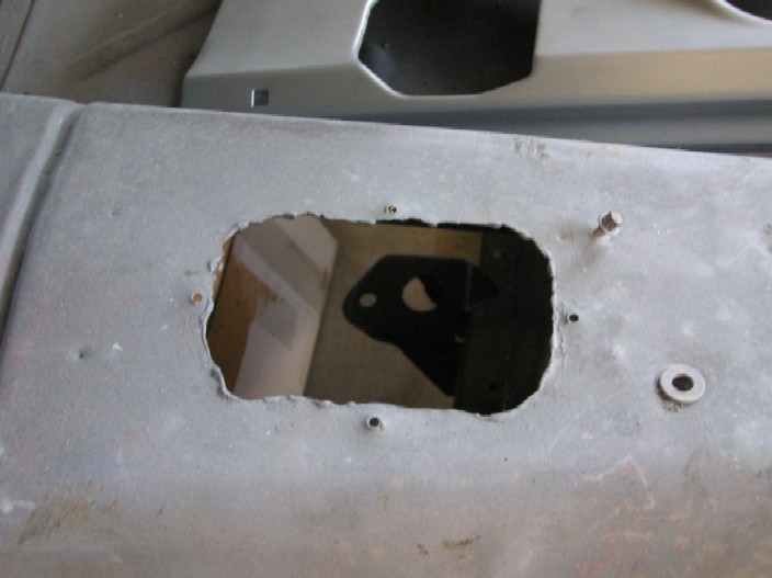

Correct, Beater is a clean hole with a ring on the underside if he needs a pic I can get one, you do not need to move your console mine is to the bare floor now, mine is there but has been cut on the side for another shifter at one time.

This is a factory hole slightly modified in beater
