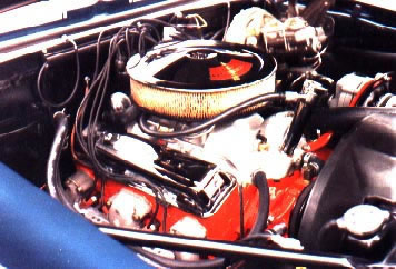

I think this is another photo of the Norwood 6B Marina Blue 67 Z28 pictured on Jerry MacNeish's website:
The restoration photos on www.67z28.net are of my Deepwater Blue car 67 Z28, also a Norwood 6B car. Here are some before and after photos of the cowl area. Although the car had been repainted when I stripped her down, I think I was still able to determine how the factory had painted the area:
Before:
After:

More pics of cowl area from the Marina Blue car, a highly original 40K mile Norwood 6B 1967 Z28:
