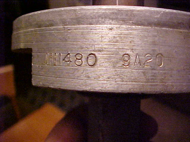

I picked this up 2 weeks ago and I think it's real. Does anyone have a list of real dates for the 480 499 and 170 distributor dates that they could PM me.Been seeing a lot more of these at the meets. Please look at the attachment and let me know. Thanks guys

Its a good one, not a restamp.
