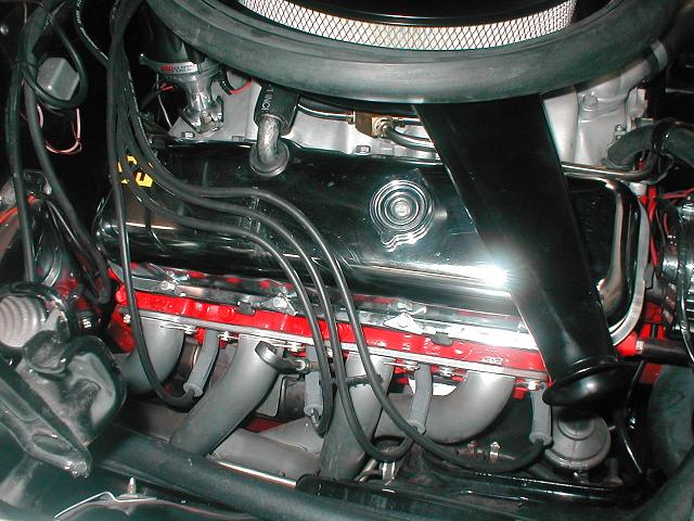

Here is a picture of the right side of a 540 with roller rockers that I installed these on. They worked great.

Larry I bought these from Noah thru e-bay several years ago. I remember the price being very reasonable and the quality was very good. The covers are canted and I think there would be room for a stud girdle.
