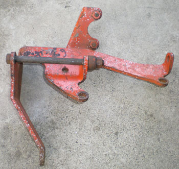

Pic 1

Old 01-31-2009, 04:24 AM
68SSCamaro 68SSCamaro is offline
Join Date: May 2003
Location: Southern California
Posts: 299
Default Re: 68 BB smog bolt head markings

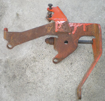

Pic 2

Thanks, mine is a LOS built 3rd week of January.
The bolts I have for the elbow in the back of the pump are RSC, grade 5. The bolts for the diverter valve to the bracket have a triangle, grade 5. Is this what you have? The pump I have is dated 3457. Tower clamps all dated 4/67. This has been pieced together from 2 groups of parts.
If you could post a photo of the adjusting brace I would appreciate it. That's the one piece I have that might not be correct.
