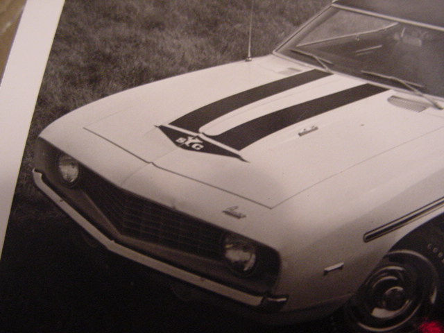

The arrow does not always belong on the flat. My first Yenko [O6A] the arrow was @13 inches back from the peak of the hood. I have seen the later cars with this treatment more often than not. Most guys will not put it back there even if its without question that's the way it was. I was told by several "experts" that that stripe was wrong...BKH

Brian is right, here's a shot taken in the summer of '69 showing the stripe way up on the scoop. (and a big 'ol dent in the header panel too!) As I said, they probably weren't designed to be that short, but many were... If you're doing a clone you can end them wherever you want, but if i was restoring the car in this picture, well theres really no question where those ones should be.

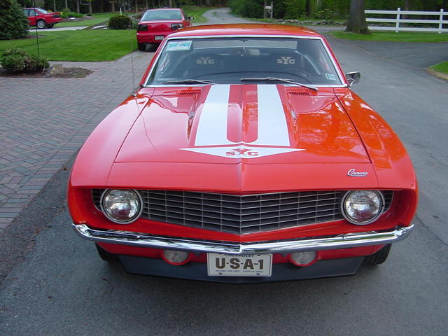

Another thing I've seen variations on is the hood stripes themselves... The car pictured above has the outer edges of the stripes following the edge of the scoop portion of the hood, "splaying" them out in a V formation... On other cars I've seen the inner portion of the stripes follow the center hood crease, with the 2 stripes running nearly parallel to each other, as in the picture below. Either way could be considered correct.

Also, In my unscientific research (comparing cars at SCR) I found the front of the side stripe to generally start about 1" back from the rear of the side marker, but in the pic Joe posted, it starts farther back.
