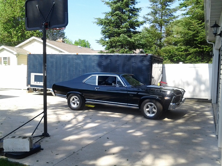

I had the vintage Keystone modified to a 15x8 and am running the M&H on my sister's 69 Nova. It is tight but if you want to make them work, you can.
To stay off the shock, there are options with relocating the lower shock mount, via a traction bar or simply using a shock that doesn't have a tin dust shield.
I post a pic in a bit
