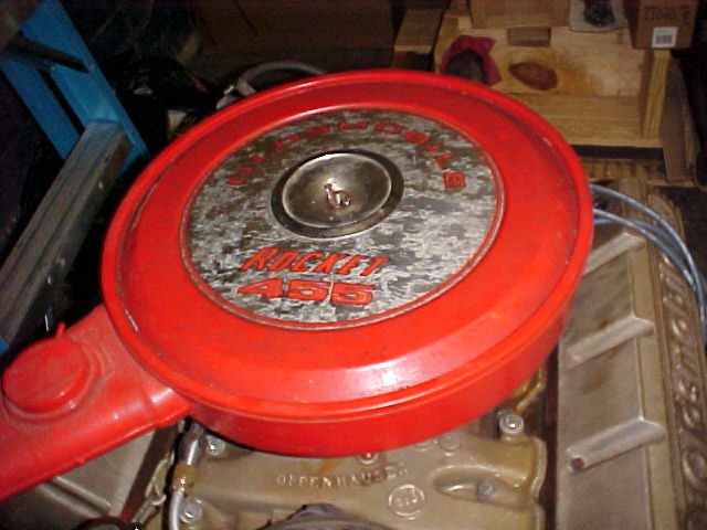

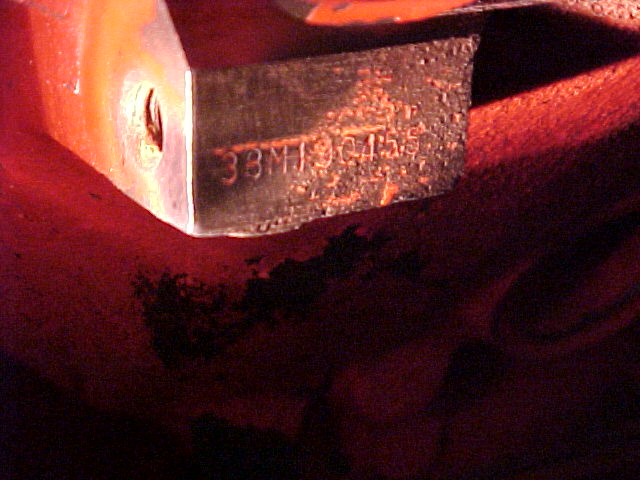

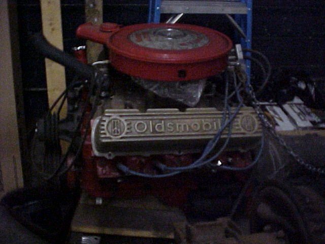

...here are some photos of the motor
Old 02-18-2007, 01:01 AM
John's Avatar
John John is offline
Join Date: Nov 2001
Posts: 3,395
Thanks: 2,778
Default Re: olds 455 Rocket engine ID
...air cleaner photo
