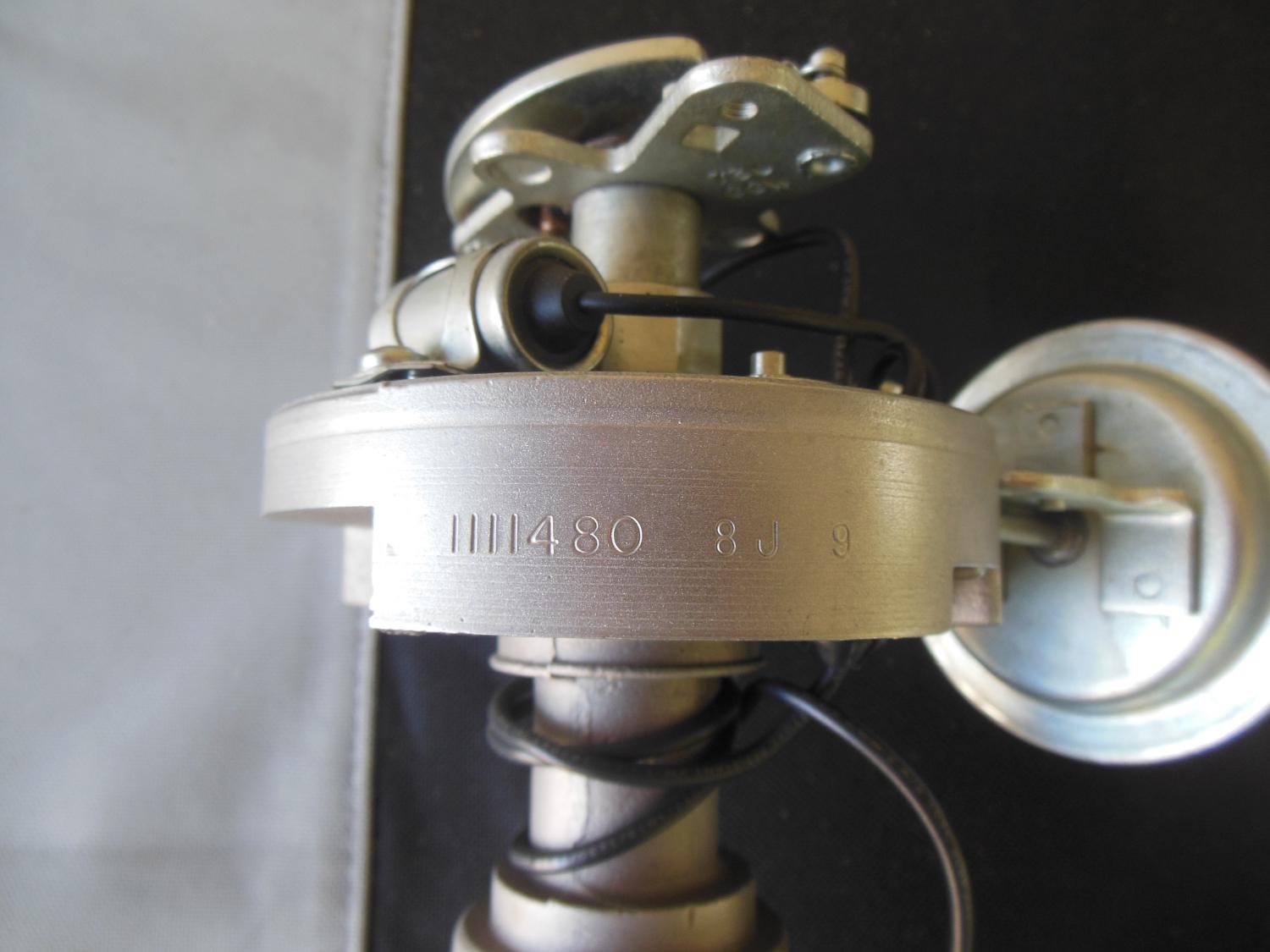

do these look original

8 J 9 is a restamp on my opinion.
I think the other two are legit.

I agree

The inside of the number 4..The inner circle of the 4 is not rounded off like the first two examples. I has sharpe edges

agree with Lynn. First 2 are legit the 8 J 9 is a restamp.
