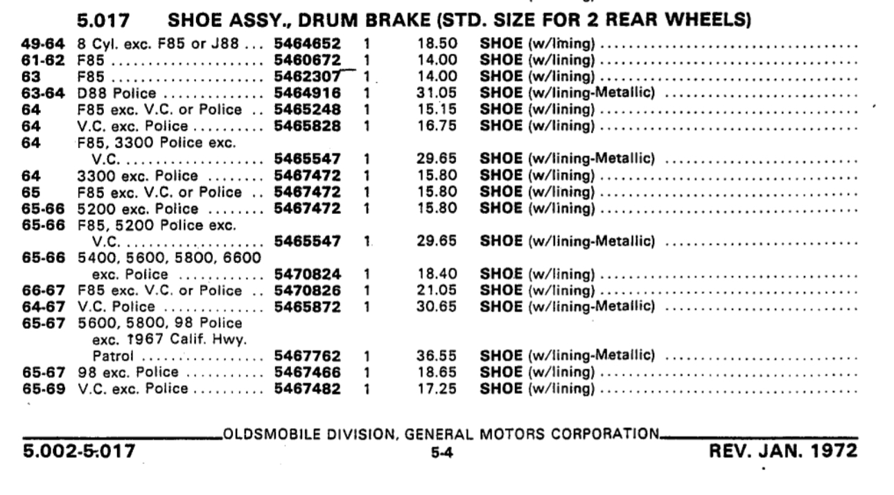

Default Application
Here you go.

Chris,
Just needed to confirm they are fronts? The parts book page shows rear???
Also what model is the Olds VC? Vista Cruiser?

this sheet Hawkeye posted is the same group as the one I found this morning but the one I found on GM Parts Wiki shows front brakes. Interesting the same group and one clearly shows Front and the other Rears
http://www.gmpartswiki.com/getbigpage?pageid=89594
