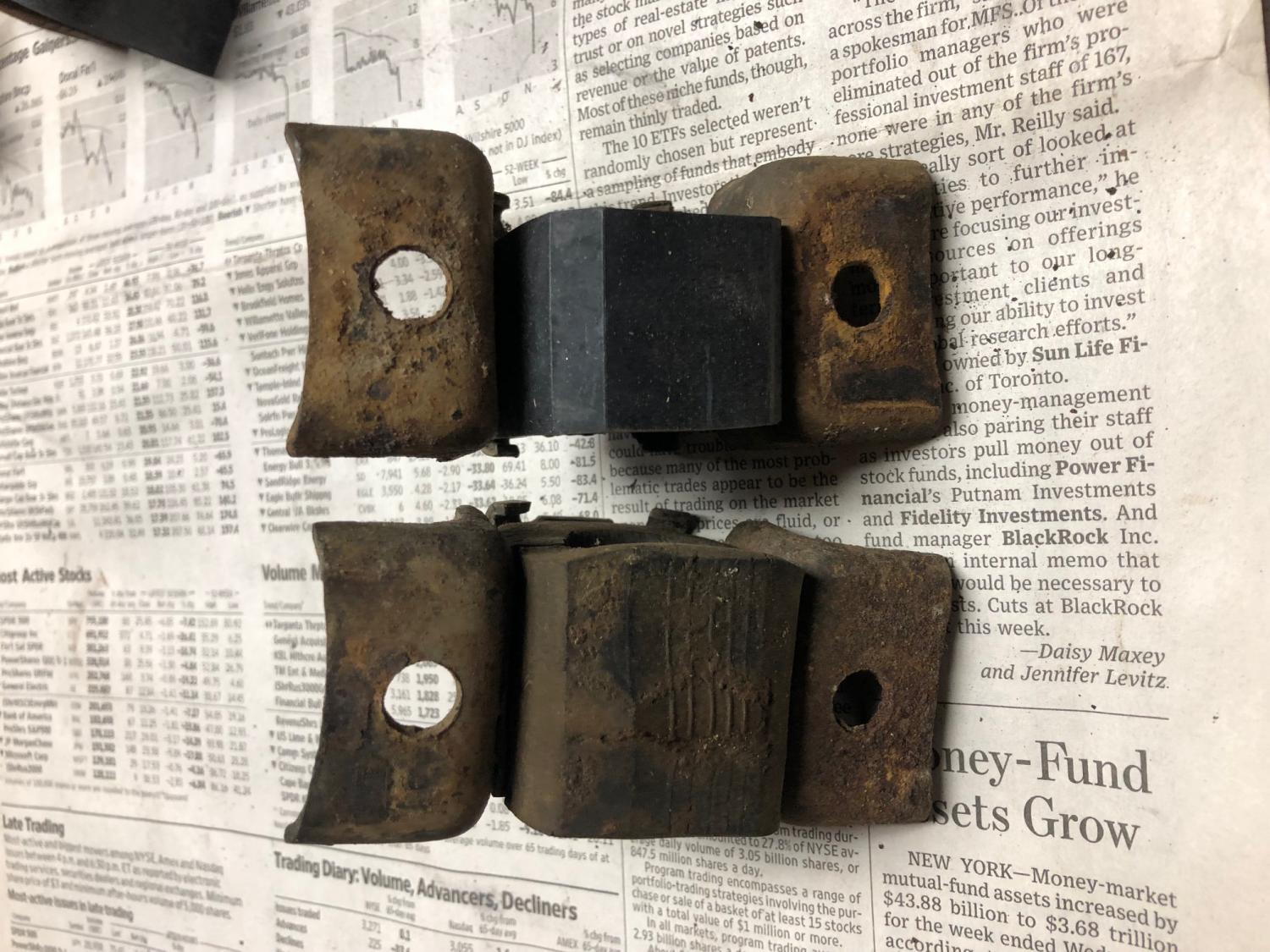

I am having the ruffest time finding the correct swaybar bushings for my 69 z/28 car . does anyone have a good part # and brand my parts stores keep getting the wrong ones to small to big to wide to narrow !! Checked with my chevrolet dealer no help thanks

Yes but there were two styles of bracket, one with 'fingers' used from around mid-production, and an earlier style without. The bushings are different and the one most parts vendors stock fits the early style.

Thats correct my car is a late car and it has the brackets with the fingers on the sides. There has to be a correct bushing out there !!
