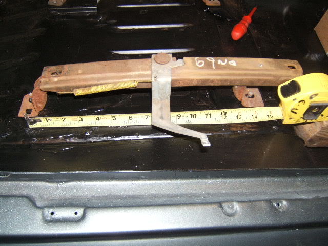

Need some advice on what seat tracks will work or are correct to fit 68 nova bucket seats are camaro or chevelle the same
Attachments - The Supercar Registry 2006_0130_171320.jpg 2006_0130_171244.JPG 2006_0130_171106.JPG

I discovered last year when I but bucket seats in my 69 Nova, that only Nova tracks work. Chevelle, Camaro, etc are different. I found an original set of tracks, but it wasn't easy. I understand the Nova seat tracks are now reproduced.

I didn't know they were reproducing 68-71 nova bucket seat tracks. I saw they were reproducing A-body bucket seat tracks. The A-body are an inch longer on the floor mounting hole to floor mounting hole. If I remember correctly A-body are 15" and 15.5 inches and Nova's are 14" and 14.5". The mounting holes that attach the tracks to the seat frame are the same dimensions. The seat frames are interchangeable between Nova and A-body. 68 has the release button on the side 69-71 has the release button in the center of seat back.

Thats correct the mounting studs are 14" and 14 1/2" on my car
