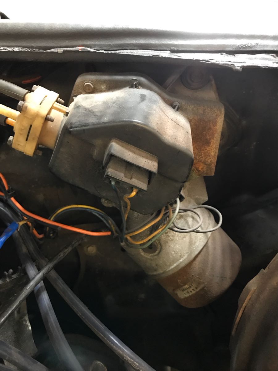

The wiper blade arms and the wiper blade motor is different on a Base line Chevelle model 300. The non-hidden wiper motor is the box type such as you would find on a Camaro or Nova.

I thought I would post up my car’s wipers a may be easier
