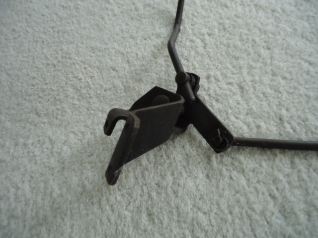

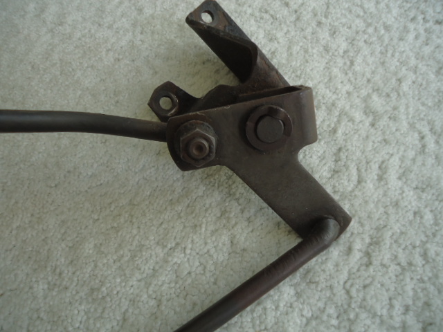

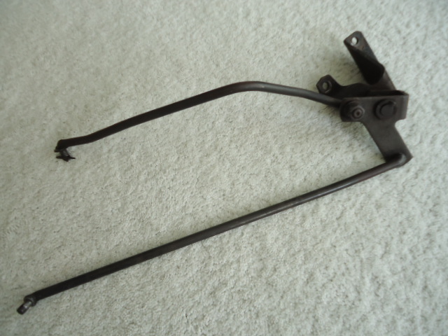

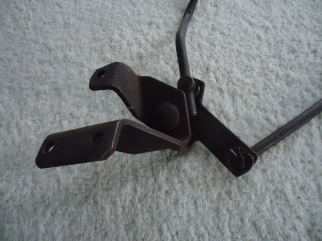

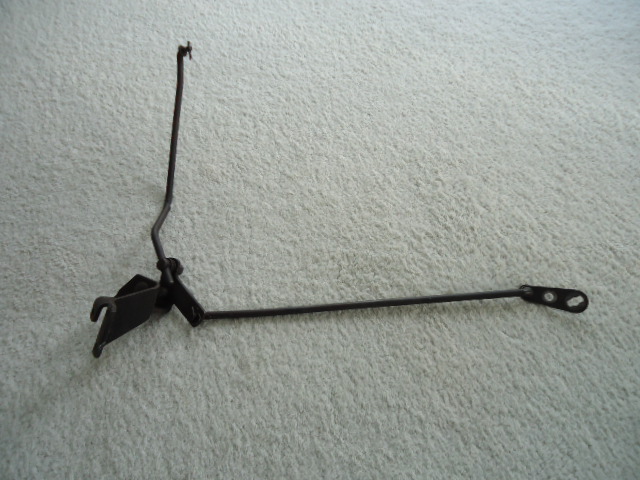

Is the part number 2605 the correct reverse lockout rod
Old 06-20-2017, 01:49 AM
Posts: 20,927
Thanked 3,556 Times in 1,436 Posts
No,that's for a 1970,1973,1974 Nova.
The correct one you want for a 1969-72 Chevelle Muncie 4spd. is 5497 Lower & 2889 Upper.
The correct one you want for a 1969-72 Chevelle Saginaw 4spd. is 2890 Lower & 2888 Upper.
