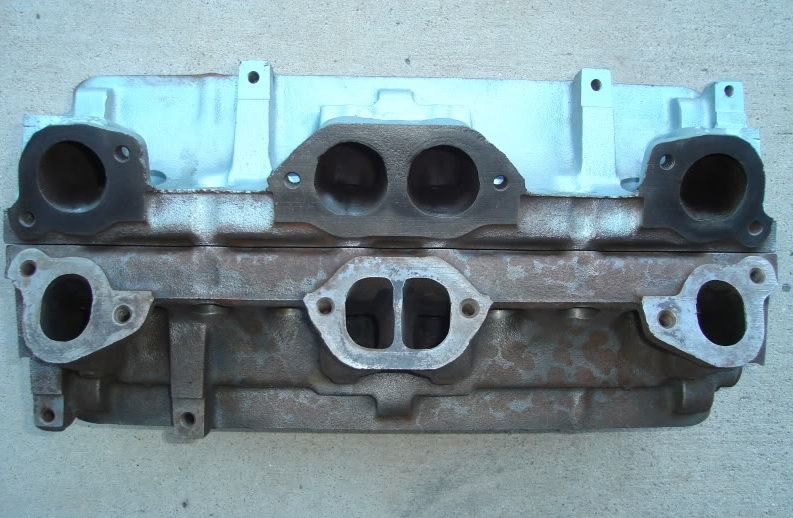

Jason, that's the standard d-port Pontiac configuration.
The d-port verbiage comes from the fact that center two exhaust ports are one large oval, but have a dividing wall, so it looks like a couple back-to-back D's (bottom).
The round port heads have 4 large exhaust ports, all separated. Those are RAII, RAIV, and SD-455 (top).

Don't forget the '71-'72 455 HO round port engines.

Awesome that is just what I was looking for. The owner drove the car into my garage and shut it off. When I got it on the lift I new it was going to need an exhaust. Well I installed a new exhaust started it up and exhaust manifold leaks both sides. I was able to drop the passenger side down to get this one out. The driver side is going to be tricky. The Z-bar is in the way of the back bolt on drivers side. The drivers side is stuffed in there. So if I had taken the manifold all the way out I would have seen that D port. Thanks for the pictures greatly appreciated.

<div class="ubbcode-block"><div class="ubbcode-header">Originally Posted By: 68 Vert</div><div class="ubbcode-body">Don't forget the '71-'72 455 HO round port engines. </div></div>
Yes, and I forgot the 1971-1972 455 H.O.'s.
