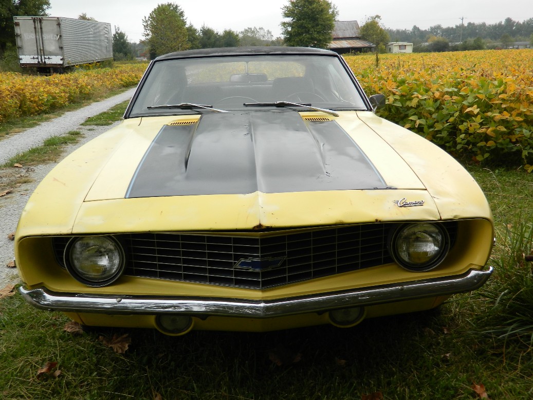

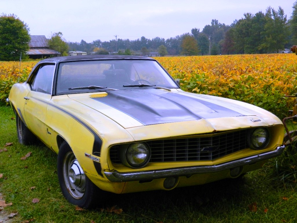

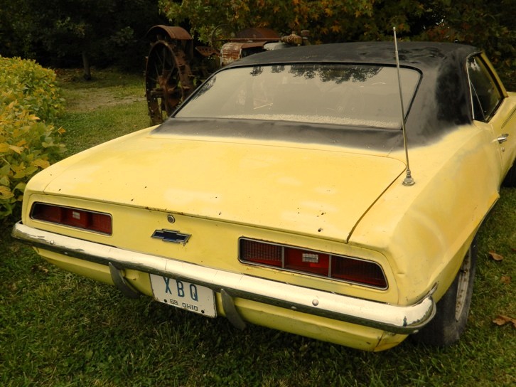

Been gathering up the Day II goodies for some time. After a year of planning and parts scrounging, I am introducing hopefully by summer "Project Ratty Rat". Why Ratty Rat? This will be a little different departure than most builds on here. It is done on a budget. Huh? Yes, I am going to build the worlds(possibly)cheapest COPO clone 69 Camaro. The car I am using is my Daytona Yellow sport coupe. built the last week of March of 69 at Norwood, This car is the perfect candidate. I am purposely going to make the antithesis of Grady's beautiful real COPO. This car will look as if it was just pried out of it's tomb after 48 years of slumber. So don't look for a detailed rotisserie type build, but rather a COPO (clone) that you may need a tetanus shot to get close to. One unique feature of this car is that it retains much of its original paint and was ordered with D90 stripe.

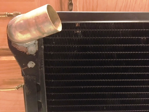

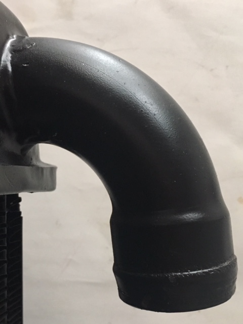

The Radiator Saga:
I have a displeasure and distrust for repop parts. That said, I had to swallow hard and make a decision on a radiator. The tendency these days are to lean aluminum. I could not find an aluminum that looked both correct and affordable. I zeroed in on a traditional brass 4 core curved neck made by US Radiator. Had I known that I would get something that did not reflect the picture in the catalog, I would not have bought it. To make matters worse, after the fact, I found a REAL curve neck 4 core all recored and correctly restored that the guy I bought the engine from had. Too bad the guy is a total D%#k and I really don't want any more dealings with him*. Besides, the added unplanned cost, since I had already checked off the radiator purchase, well, the money wasn't there and he was waffling on selling the thing anyway.
Back to the radiator I bought from US Rad. The curve neck, probably the most important visual was made all wrong. The picture showed one diameter neck, like the real ones. When I pulled it out of the box, only the 1st 1/2 in. was the correct diameter, then it necked down. On top of that, the neck was not angled up like it should be. Fortunately, I have a real curve neck for my other BB Camaro to go by in correcting this. I took a chrome "J" trap sink drain used in plumbing. I cut to length, removed the chrome and you can see the result. I also added the top rail slots like an original, as well. Total cost= $365

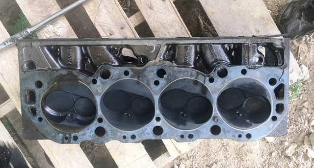

The 427 saga or the Good, Bad & Ugly:
Last July, I buy this "homemade" 427 using a late 70s 289 casting 454 block. It was not blown up. The guy could not find the balancer or distributor or air cleaner. Later he found the last 2, but would not give them to me. Is everyone crooked in this country? He said that he was mad because the heads (69 291 castings) were worth what I gave for the engine. Not my fault. Guy admitted he was not an engine guy and was disappointed that it was not a true 427. Besides the engine did not sound right, according to his late father in law, but no one investigated the problem. 1st picture is the day I bought it and it is in the back of my Explorer. The Good: Balanced 11:1 closed chamber square port with intake, CC Magnum 280 hyd. cam. The Bad: Problems found, detonation had beat the bearings to the copper at the top rod end on all 8. Blown head gasket on #7. Block has a sleeve and there is a slight taper getting bigger in the bottom of the bore. Crank needs turned. No biggie. Ugly: Bearings, crank needed turning, pistons fly cut valve pockets, no attempt to debur and smooth radiuses to prevent detonation. A cam that did not adequately bleed off effective compression.
