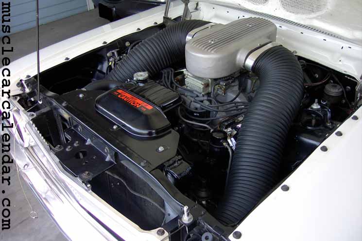

I dont know how many know this, but I guess chevy really was ahead of its time compared to ford and chrysler in 69-70 in atleast one area. In an old book, I read yesterday that duntov said cowl induction basically took 7 seconds off the 0-140mph speed when comparing a 67 L88 vette to a 68. To me that is a ton of time difference on one particular supercar type! I imagine some is related to wind resistence reduction (when compared to a stinger) and the rest is mostly the pressurized air (resulting in more horsepower).
So maybe those certain 69 camaros and 70 chevelles (with cowl induction) really had an edge over the mopars and fords on the open road races (once you got over 100).
I tip my hat in the chevy direction....for today..

Yes, but Smokey's &quot;at speed&quot; was NASCAR speed, as in 150+ mph. On a street car, even a fast drag car, there is virtually no ram effect, and certainly not through a plenum or cowl setup.
Holding your arm out the window and cupping your hand, you feel tremendous pressure. But getting that air to the carb, through a series of hoses, elbows, or ducting, you lose a lot of pressure. When that pressurized air does get to the carb, it has to overcome a wide open throttle condition, a carb that's gulping in huge amounts of air on every stroke, to the tune of around 800 cubic feet per minute, and then you need to build up even MORE pressure to force air into the cylinders, under a wide open throttle condition, revving at maybe 6,000 rpm. Air needs to fill the cylinders and carb plenum, refreshing it constantly while the engine sucking down air. A forward traveling car does not produce this much pressure, unless it's traveling at a VERY high speed and a VERY good air intake setup. On a street car, add in the restriction of air filter, and there's no chance of getting a ram effect at all.
Pro Stock cars use a huge air scoop, taller than it is wide. They discovered the optimum scoop height and inlet opening via wind tunnel testing in the 1990's. The older scoops used in the 70's and 80's were sort of guess work, but they did know they had to get the scoop high, very high, much higher than even the A12 style scoop, to be effective.
The whole Ram Air thing was a great marketing ploy by Pontiac. It brought in cold air, but there was no ram effect. By attaching a name to the setup, and marketing it as something unique to Pontiacs, was a stroke of genius. To this day, more people use the term &quot;ram air&quot; than any other term when referring to an cold air intake setup or hood scoop.
I've built a lot of ram air setups, some using a mix of Pontiac and Chevy parts, some using the hose-fed idea (I did a lot of those), and I've tried headlight entry, parking light entry, separate bumper scoops, etc. In every case, the car runs BETTER. No doubt about that. It's also much quieter from the interior under full throttle.
But I have to chuckle when I see ads selling ram air kits claiming 20% hp improvements. That sounds great for yer ego, but lousy for your bank account. [img]<<GRAEMLIN_URL>>/wink.gif[/img]
