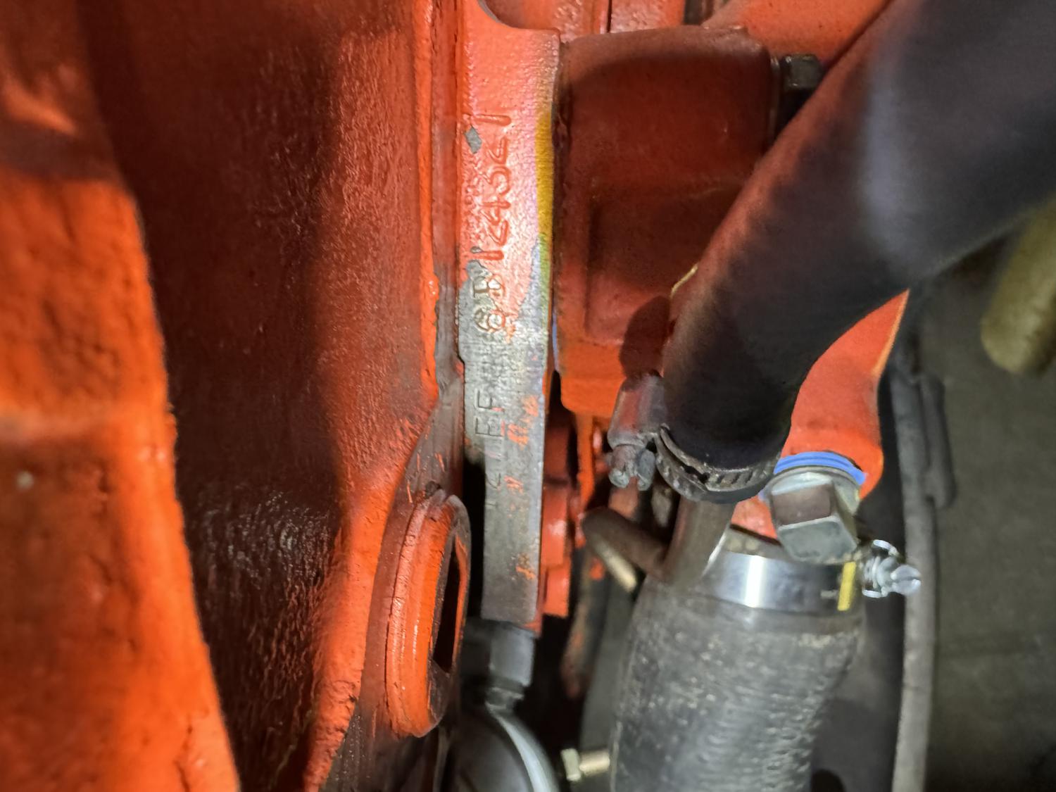

My question is about the driveshaft stripe color, i believe that the drive shaft is original to the car and has what i believe to be an orange, blue and white stripe and was curious of what this could mean as i dont have build sheet.
Pics attached
