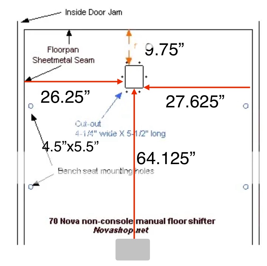

I've attached some reference from another site. I'm trying to get placement of the non console 4speed hole. I replaced the tunnel and the previous was opened up beyond recognition. Can anyone tell me does the hole start off the center or how far over to the driver side. The 8" back from the seam seems correct. Any information appreciated as usual.
