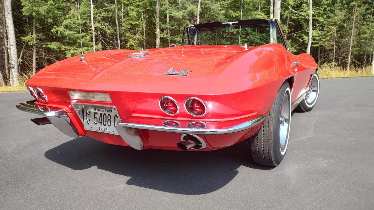

Within the last 2 weeks, I caught a wiff of a 67 roadster from another forum member. He gave me the back story of the car, along with some pics of the car, engine pad, trim tag, VIN tag, and the like.
The car sounded like it may prove to be a good car for the dealership, as I always have people looking for a good 67 L79. It was thought that the car was primarily an original paint car, coming from it's 2nd owner (owned since 1975) in North Carolina. 51k miles, born with drivetrain, and largely left alone. The car was represented to have it's original POP, owners manual / bag, and a tank sticker that is still on the tank. A low option car, only equipped with the aforementioned L79, 4 speed, 3.36 posi, AM / FM, whitewalls, and auxiliary hardtop.
