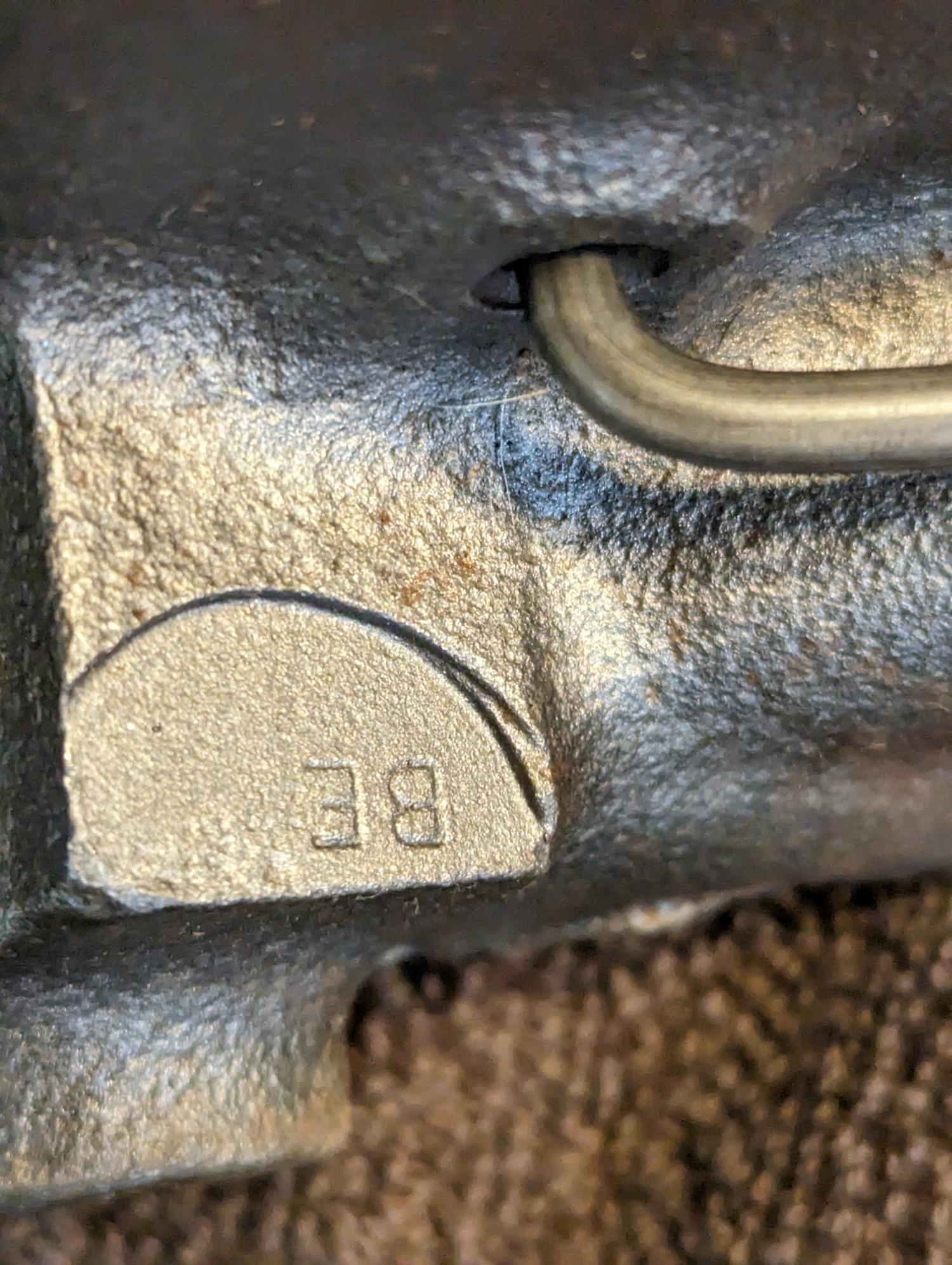

I thought a list of the different master cylinder codes could be helpful. The codes appear in the 68 and newer Buick, Pontiac, and Chevrolet chassis service manuals. Anyone able to add the Oldsmobile codes (section 5 of the manual) or the 1970 Chevy?
I kept the list short and simple, so there may be more info in the service manual.

Attachments - The Supercar Registry MasCyl.70Cam.409Casting 008.jpg MasCyl.70Cam.409Casting 001.jpg 71 Cutlass BE master.jpg 67firebird_MCcode_resized.jpg
