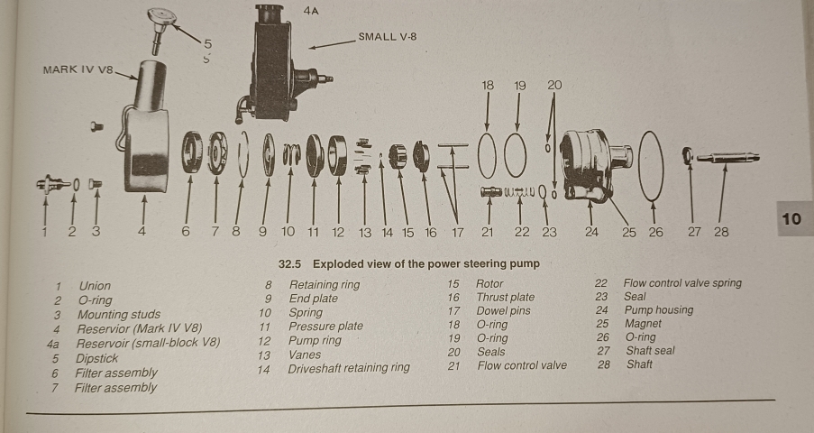

I found a round 1" X 1/4" Magnet inside a 1976 Corvette P/S pump while re-sealing it and for the life of me, I don't see where it would go upon re-assembly other than sticking it inside the can (reservoir). Any input? Bill
