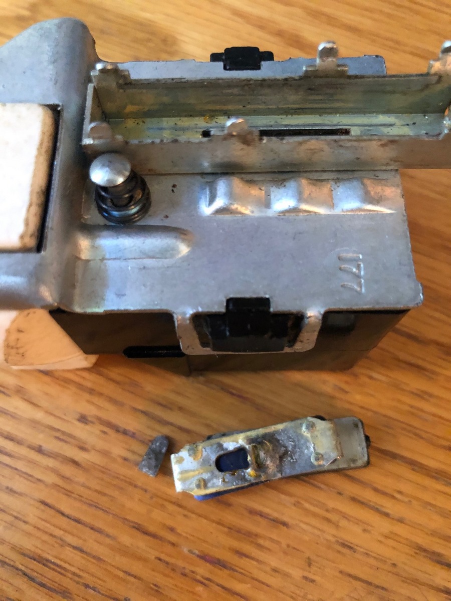

I took my Z out the other day and when i turned the lights on the Vacuum doors did not open. If i manually move the switch on the valve that is on the canister, they open right up. The two vacuum hose's going from the light switch to the canister valve have vacuum on both sides with the light switch on of off. So i am thinking the light switch is the problem??
Thanks
Kenny
