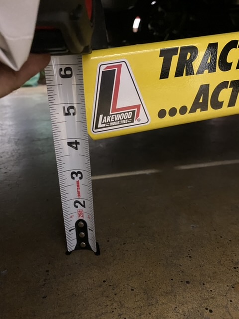

I decided to bolt it together, without the wedges, utilizing the lower spring insulator and it worked great. Unfortunately, this manner of installation isn’t possible because the bars hang far too low to the ground (see picture) and have a tremendous amount of gap between the snubber and the leaf. My understanding is that 1/2” gap is the max you should run.
