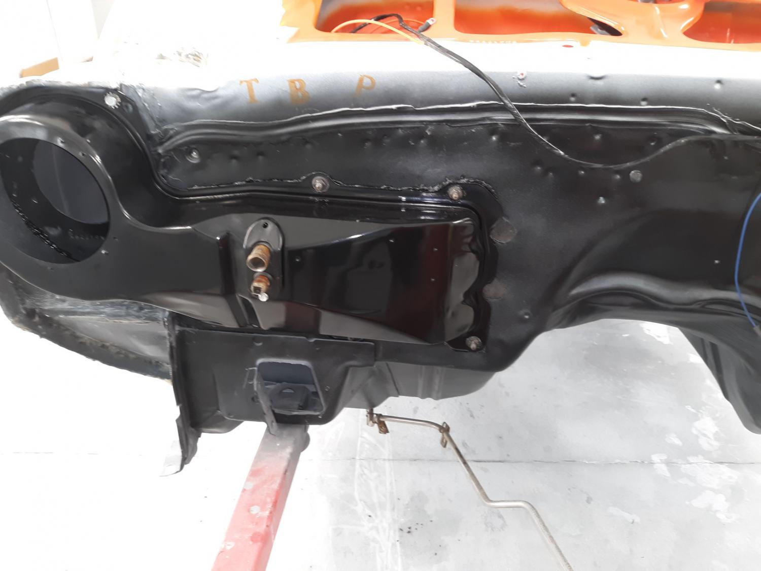

I purchased this car from a member here (thanks Max). The "for sale" thread was "69 Indy L-78 M-22 Project". Since purchasing the car, I have been able to locate the selling dealer (thanks to NCRS) and all previous owners. The car body is on a rotisserie and being restored by James - a member here. Drive train is restored and awaiting completion of body work.
This is a new thread to post pictures of the restoration progress. One of my concerns was that the center of the dash panel had rust right up through the first two speaker grille slots. Thankfully, the outboard dash areas, including the VIN area, were good, so we really didn't want to replace the panel (re-pro panels are not accurate, plus we didn't want to ever remove the VIN tag). James has done an amazing job piecing in fresh metal and even making part of the speaker grille cut-out with a hand file!
I'll leave it to James to post pictures as the restoration progresses.
