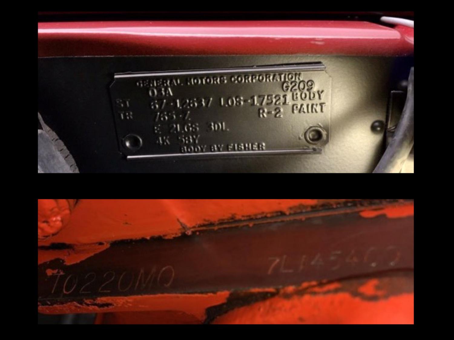

What are your thoughts on this car? isn't it's cowl tag build date a little early for a L78?
https://bringatrailer.com/listing/19...et-camaro-105/
