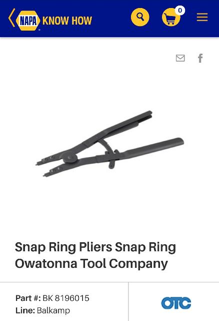

Looking for what you think the best pair of snap ring pliers are out there. Trying to get the middle bearing retainer snap ring off muncie 4 speeds. Its inevitable that builders install it backwards on the shaft making it almost impossible to remove. I have a good set of SK with offset tabs that work good if you can get straight on it. The problem being most of the time the speed-o gear is still on shaft blocking the removal of the reverse gear. Which causes you to have to be at an angle. The typical ones that you install tips on don't even touch it. Thanks in advance. Larry
